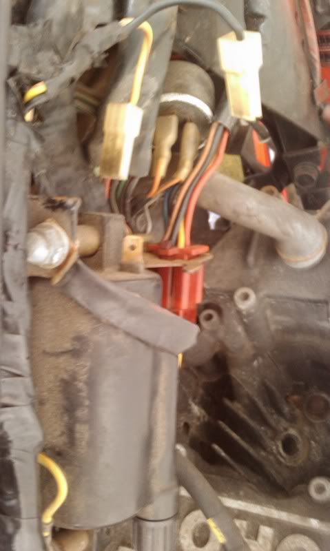

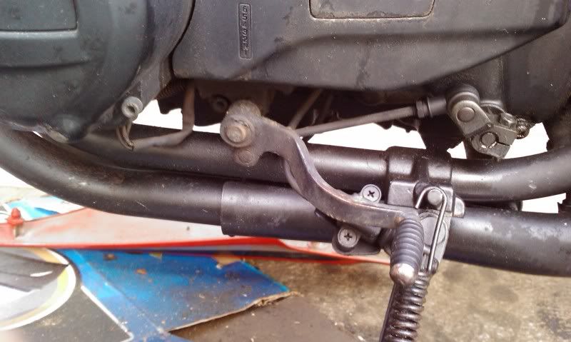

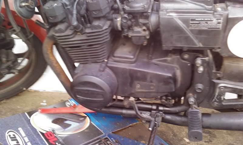

I've taken a couple photos so that it might help you guys help me find the right wire
(pardon my stupid newbie move, of not being able to find the wire)i34.photobucket.com/albums/d110/will_dou/IMAGE_107.jpg
This one's on the left side of the bike. There's a wire sticking out the engine cover, which is half cut off in the picture, on the very left side. I don't know where that leads to actually.
i34.photobucket.com/albums/d110/will_dou/IMAGE_108.jpg
Here's a picture of the perspective zoomed out, so you can see where that is.
This is the right side of the bike, another wire coming out of the cover. It goes to the igniter(sp) in the next picture (the more silvery one)
Is the black one the rectifier?
#3 I read in an older post where someone tested to see if the spark plugs were making sparks (I think). How do I test this, if I need to?
Thanks!

Your cylinders fire in pairs. 1 and 4 at the same time, and 2 and 3 at the same time. If 1 fires, then 4 is likely firing too. Same goes for 2 and 3. The only way one cylinder won't spark is if you have a shorted plug wire, or bad plug, or the coil is faulty.
If 1 or 4 don't fire, swap the spark plug wires for 1 and 4. If the problem moves to the other cylinder, then the coil, or wire is bad. If the problem stays on the original cylinder, then the plug is bad or the carb/mixture is wrong on that cylinder.
To test for spark outside the engine, take out all the plugs so that cranking the engine will be easier without the compression. Keep each plug wire connected to it's plug and make sure the metal part of the plug is laying on the engine. Crank the engine over. There should be sparks on each plug once per crank revolution.
If the battery is strong enough to start the bike, it is strong enough to run the engine. If you are losing voltage to the coils (you don't say how you "showed 10 amps") then there is a wiring issue or dirty connections/switches/fuses. Your whole ignition will use about 3 to 4 amps in total, by the way. (13v / 2.5amps)*(2 coils * .33 duty cycle) = about 3.5 amps.
