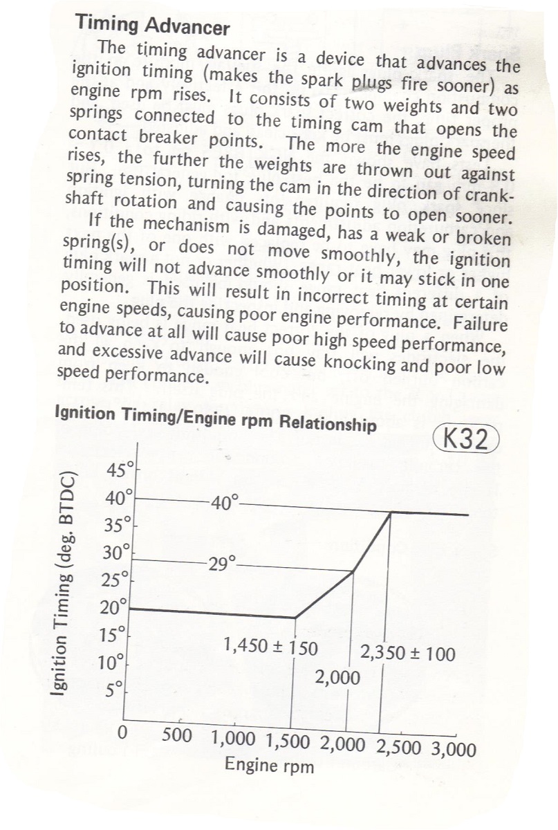

The ignition advance tracks what the engine needs to make power. Here is the curve for 750 twin from the manual. After I made new springs, mine advances faster than the curve but seems to run better. I run premium gas to make sure it doesn't ping. Note that the advancing action doesn't start until about 1500 RPM.

Does anyone have the stock advance curve for a 77 kz1000? Also would the curve need to change if a Dyna ignition and 3 Ohm coils are installed?
- Posts: 18564
- Thanks: 2103
Re: Your Timing Advancer May Be Screwing You
26 May 2014 19:15richrand wrote: Does anyone have the stock advance curve for a 77 kz1000? Also would the curve need to change if a Dyna ignition and 3 Ohm coils are installed?
Same curve with Dyna ignition and 3 Ohm coils.
