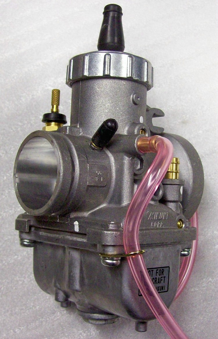

Off hand, can anyone tell me how to differentiate a real VM30 from a fake? I'd be royally pissed if they sold me fakes too.

Yeah, that's why I went with the Chinese knockoffs. I knew any "kit" was still going to take a lot of extra running around and problem solving. The knockoffs, with other parts required, ended up less than half the price of the kits.
In the build thread I included details about the main jets. Real Mikuni will have a non-standard bolt thread. The Chinese knockoff main jets use a standard thread. This allows us to use Keihin, Teikei, and Dynojet main jets, which luckily we have a bunch laying around from our 550's. So the main jet thread will distinguish the Chinese carbs from real Mikuni. If they say Mikuni on them, like the photo Scirocco posted, they are more likely to be real. The fake ones have no cast-in name. But I think the jet thread is a better method of distinguishing.
