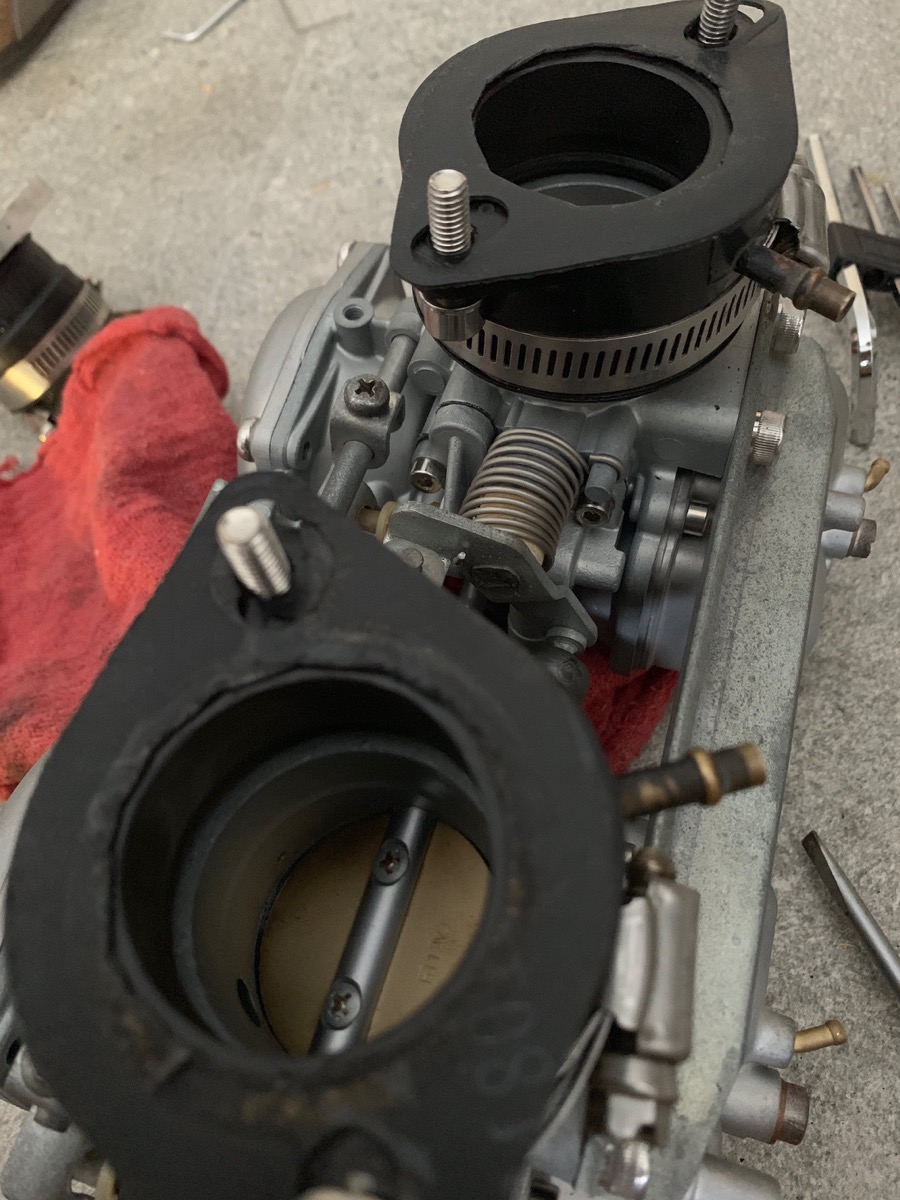

I recently found new (old) BS-38s for my KZ750B after fighting with the VM34s for over a year and not getting the bike to run properly. Plug after plug got carbonized, bike was running too rich, tried everything single pilot out there with every float height and setup and nothing did it. My next step was, let's try the original carburetors this bike was designed for. I finally got them and got the new (old) boots as well, but they’re an incredible tight fit. I can only get the carbs half way in, can’t go over the rubber 'ring' that's in the middle that I’m guessing is was fully holds them in place. Is it suppose to be this difficult to get them in ? Also do I use a gasket between the boots and the engine or just screw them in without any gasket?

The lower one in the picture looks used. If the rubber is hard, there is a good chance they will leak. A picture or two from the side might make it more clear to forum members if the boots are fully seated.
No gasket should be used. If the rubber is hard, they will not seal. Some Three-Bond or Hylomar may help for a while, but they will only work if the rubber is supple.

I've found that a little swirl of Vasoline in the carb holders helps things along.
And if you can get a wooden 2x3 or I think I used a 1 1/2 x 1 1/2 square piece of wood to gently pry on each carb in turn they'll suddenly plop into place.
I'm about to do the same in a couple of days once the weather warms up. I'm not looking forward to it but at least I have new supple carb holders.

Just wipe a bit of oil or grease around the inside and they should pop on.

Make sure the clamps are floppy loose.

I managed to snap them in place using a little bit of red n tacky but that was with the boots not installed of course, would’ve been impossible if they were mounted on the engine. Getting them screwed to the engine was another challenge. The rubber is definitely rock hard, no way they were made that tight of a fit. Looking for a better solution for boots though if i find one I’ll post.

I have good luck with a blow dryer (or, even better, a heat gun) for all of my hard rubber parts. Might be worth a shot!
