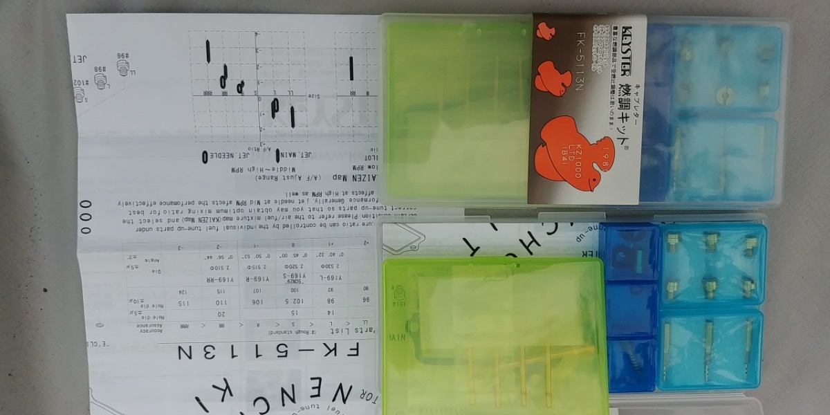

The bike has 30,000 miles. No obvious tuning complaints, I've owned for long time and don't have similar bike to compare performance. I assume it left the factory with conservative fuel system setup. Installed new float needle valves & seats (Keyster) due to carb overflow if petcock was left on. Just set float height at spec. 4mm in reference to level marks/stains on floats (25 mm to body). Carb mounts were replaced OEM Kawasaki (are still soft and appear to seal) & was still intermittent popping during warm up. Needles and needle jets are original, do not see any noticeable wear. Just wondering if there is a well know adjustment to improve factory tuning.

I used Keyster only because the used carbs I bought had no Main or Pilot jest. Made more sense money wise to buy the kits, Aslo i like the rubber bowl caskets. I used FK-5394N
Not sure my jetting will help because I have K&N pods filters and a Vance and Hines 4 to 1. I currently run 15 Pilots and 113 Mains. I m going to up the pilots to 17.5. I noticed how crisp and sharp throttle response is when cold on choke. I think the pilots might need one size bigger.
