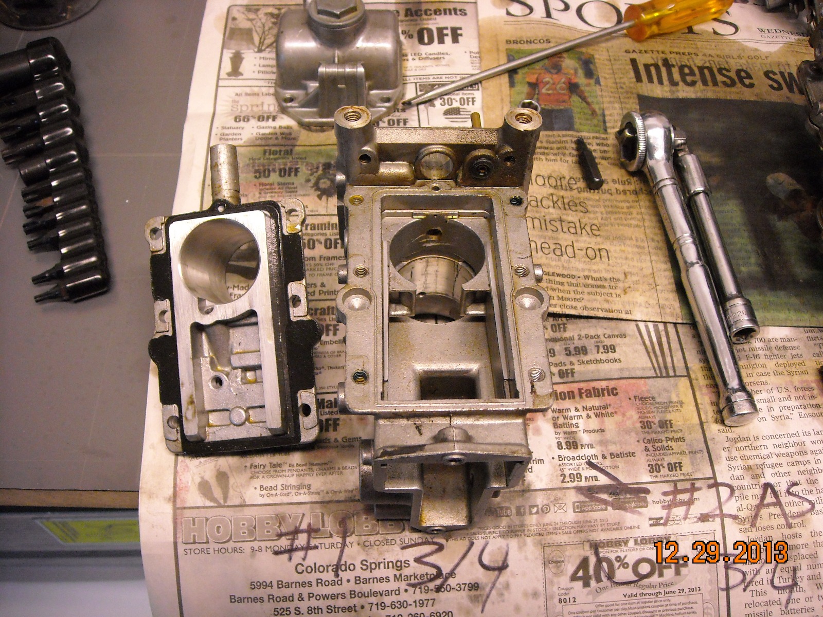

Sorry to read the flatslides have the same exact behavior in the milled out Z1 boots, e.g. hanging idle. That cured mine but lets move on. Looking back this is an interesting photo. I replaced these O-rings when I cleaned and rebuilt my set. Find the tube extending into the carb bowl, then move up and you will see the o-ring. I know you have beat the vacuum leak theory to a pulp but its probably worth shooting the joint where the o-ring resides with WD-40 or propane.
Note the picture shows my air screws position notes written on the greasy newspaper when disassembled 3/4 turns out
1981 KZ550 D1

The O-ring size in the picture is ID 3.5mm, OD 7.2mm & Width 1.8mm. I got those O-rings from McMaster Carr P/N 9464K12. The NLA gasket shown in the picture is paper thin. I do not think it seals anything.
I sounds like you replaced all the seals (Boots & O-rings) that could contribute to a hanging idle. What do you have sealing the carb boot vacuum ports? I have connected the carb vacuum port between cylinder 1 & 2 to the vacuum petcock. The needle position shouldn't be contributing to the symptom. I am running a 27.5 pilot @ 5000ft
