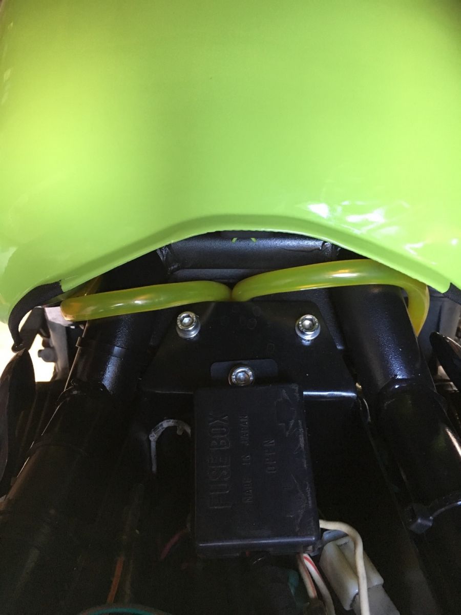

I definetly had them routed poorly. When my friend told me to loop them under the tank I didn’t quite think it through. I imagine now it’s much better. No possible way they get kinked now. But that’s what I was wondering. If they were getting pinched it may cause the problem I was having.
Here is how they are routed now

Normally they are routed through that gusset hole, as you have it in the photo, and they stop right there.

Awesome. Yeah I’ve never used that hole until now. Makes sense. I have those lines then dumping down beneath the air pods I run. I’ll cut them so they empty higher up in the better protected air. Thanks everyone

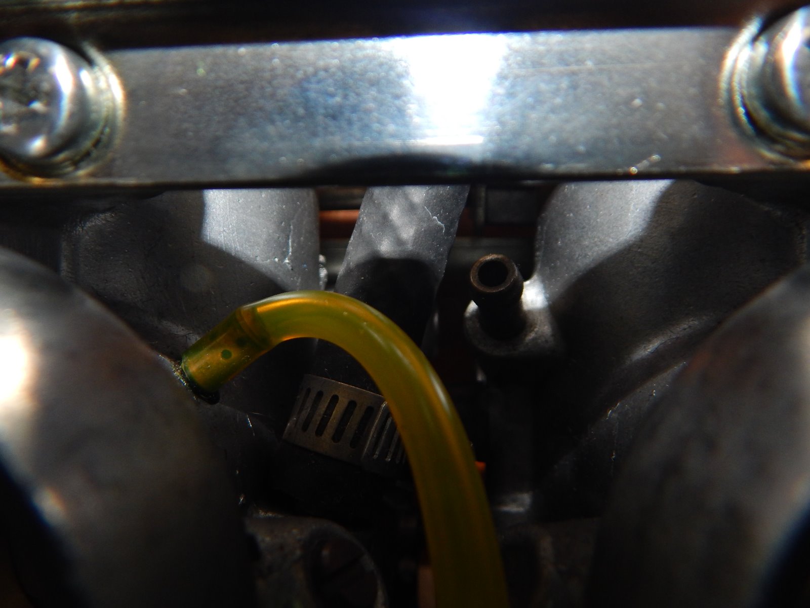

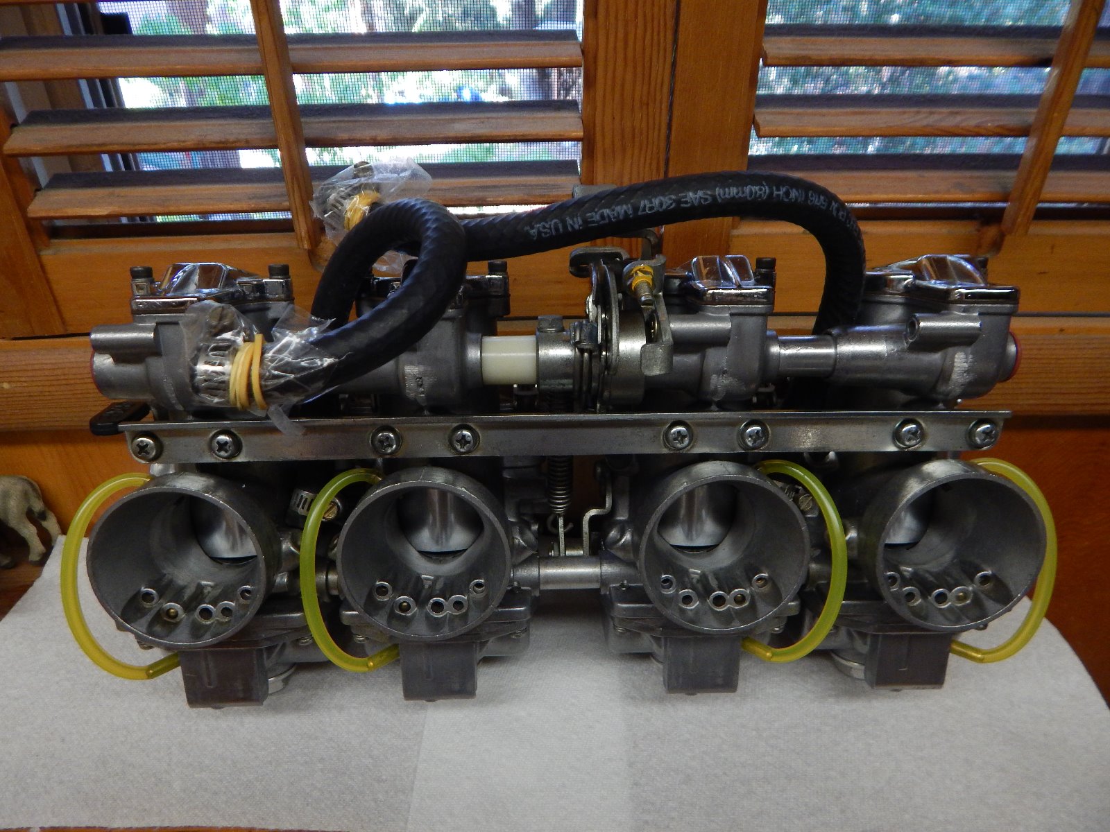

Thank you all for this info. I have a set of Mikuni 33mm smoothbores and have always wondered what those were for. (stupid me).. Are these (in the pic's) vent ports and should they have vent tube lines on them ? They are on #1 and #3 carbs, but as far back as I remember never had lines on them.
- Posts: 23782
Re: Carb Equalizer Port Question
26 Aug 2019 18:52
Yes. Does your 33's have a accelerator pump?
- urankjj
- Posts: 410
- Thanks: 261
- Posts: 23782
26 Aug 2019 19:58
Then what are those four lines about?
