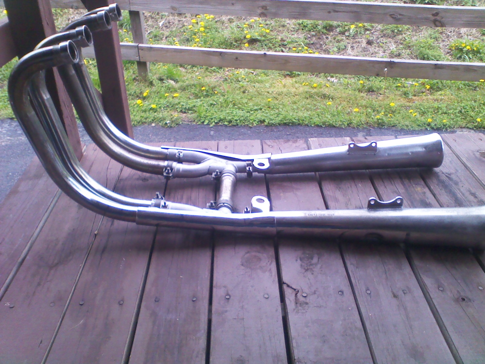

My bike used to pop occasionally with the stock exhaust. It happened quite frequently whenever my cross over exhaust pipe had a leak at those goofy flat / round gaskets. I assume from the air that was drawn into the exhaust gasses.
I still notice a pop occasionally since I installed my delkevic SS system, but I have not blocked off the air porting for the stock emission setup.. This system allows filtered air to be drawn into the exhaust ports to allow an "after-burn" of hydrocarbons in the exhaust, and hence reduces hydrocarbon emissions. It uses no HP that I know of, therefore there is no reason to disable it.

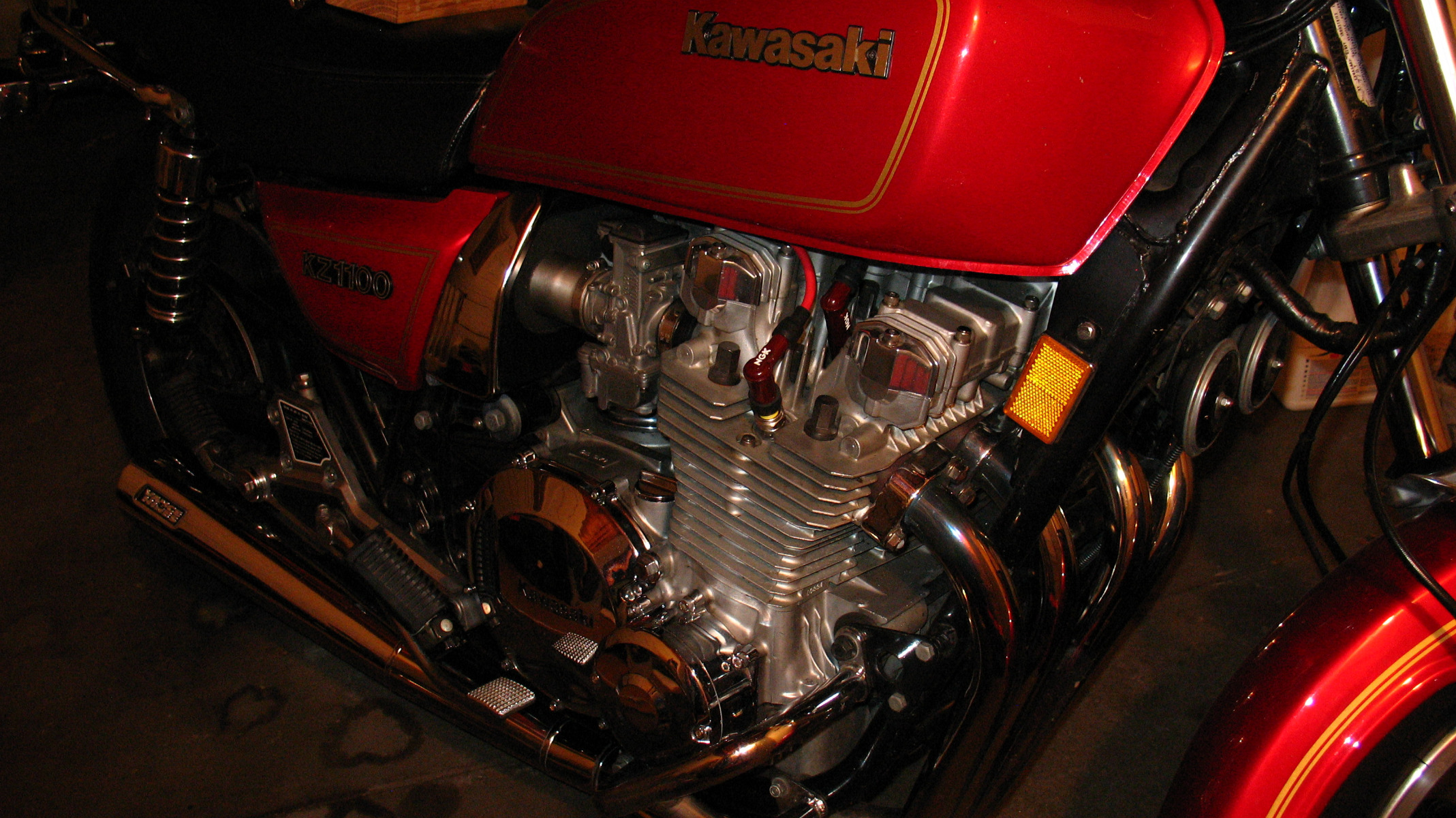

This is the setup I have. The emissions system is gone, except for the breather hose connected to the air box. Without that, the fumes were nasty when idling at a standstill for any length of time. So back to the air box, sort-of.
The carbs are Mikuni RS34, which have multiple fuel/air adjustment options compared to CV BS34's.

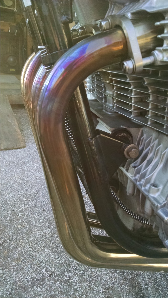

Remember, lean is mean, but it also causes overheating and contributes to blowing sh_t up. Your pipes still look pretty good (not burnt blue yet) That will change if you lean it out, then run it hard.
