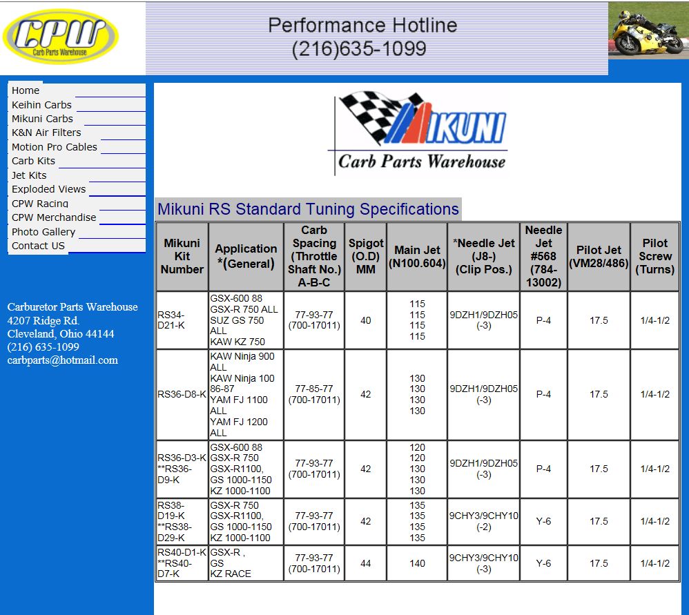

Last edit: 11 Dec 2018 00:23 by Scirocco. Reason: add Mikuni RS Standard Tuning Specifications

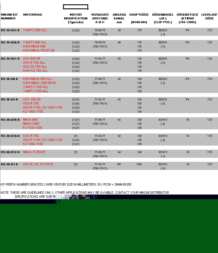

I saw the Mikuni tuning guide since that was the first thing I searched for. But since the engine will be so far from stock I didn't think the guide would be accurate. I know I need to go up on all jet sizes and I'd rather run a little rich vs a little lean.
