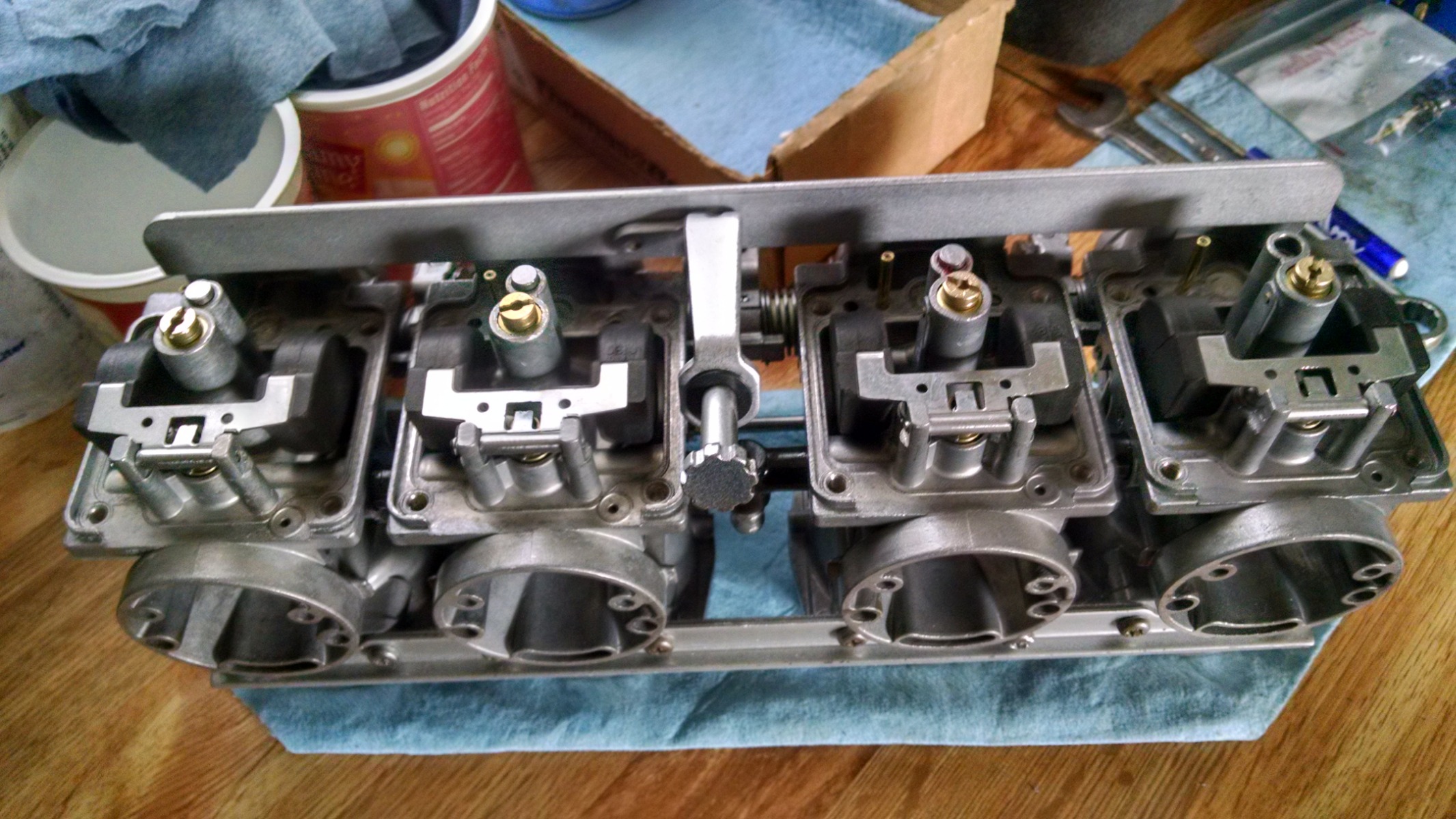

Re: Does anyone know of a GOOD KZ Carb Rebuilder?
19 Oct 2018 07:47 - 19 Oct 2018 08:11
What's the general condition of the carburetors? I would at the minimum remove them from the motorcycle, then remove the float bowls to take a look. Then using good fitting tools, remove the floats, main jets & bleeder pipes where the main jets screw in & pilot jets. and remove anything else under there I may have overlooked. Do some cleaning, then put it back together. Then decide if they really need to be sent out. I'd never really done carb work before but went ahead & did the complete disassembly & cleaning and dunked the carb bodies and I thought it was easy. The same thing is done 4 times on a lot of stuff & most parts only go back together one way, so it's kind of hard to mess up.
Last edit: 19 Oct 2018 08:11 by martin_csr.
