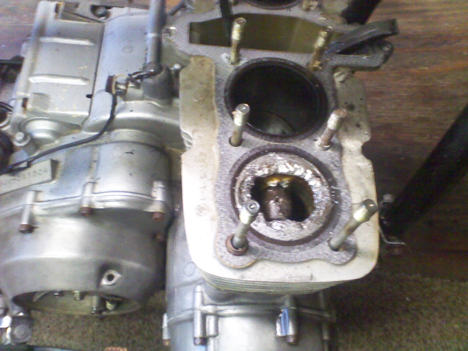

It is like a supercharger or turbo charger pushing more oxyegn molecules into the engine to mix with the fuel. On a carb setup it leans out the fuel mixture... the famous last words are "lean is mean" just before you start to burn holes in pistons and break stuff.

This is a dropped valve on a XS1100 I bought years ago, but you get the idea.
