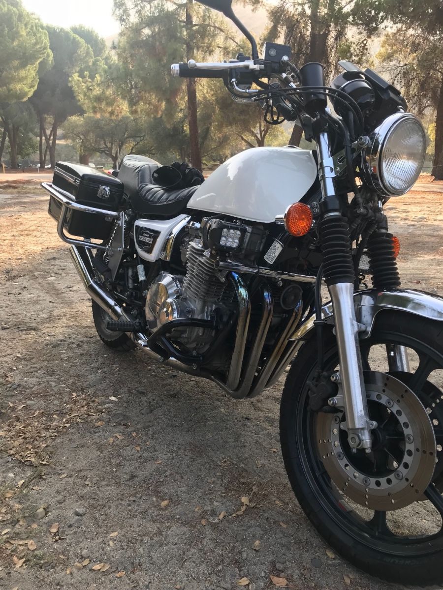

Hi everyone, I have an ex police special I have been working on. It has 65,000+ miles on it. It’s never been apart but still has 150 lbs per cylinder. I have the float levels correct and I’m working on the pilot jets now. I have stock air box and a kerker pipe with a street baffle. The carburetors have never been dirty. Stock pilots are 37.5 , I have been going up trying to get it to leave a stop sign clean. It seems to loose a cylinder right off idle. I’m at 42.5 now and it has just about gone away but still stutters a bit. I have 45s ready to go but the rest of the throttle range is great. It really rips now. Has anyone here done a similar project? I don’t want to go from poor mileage to worse. My idle screws are out 3 turns and they kind of bugs me, seems like too far out. Should I stay the course and keep pouring the coal to it?

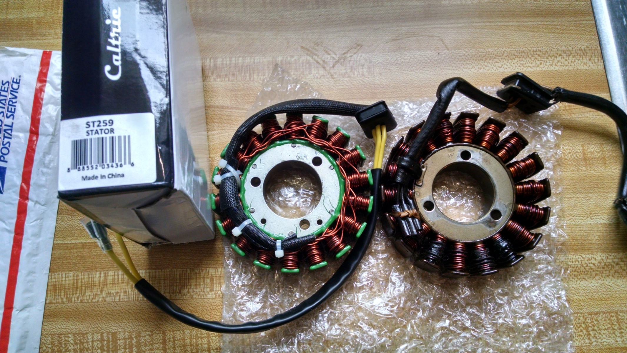

I had an off idle stumble last spring that I hunted for a bit. It turned out I had a shorted stator coil assembly. I did not realize this until I did the checking for shorts outlined in the service manual. Ohming the yellow stator wires between them checked good, but ohming to engine ground while checking for shorts was a fail, although it charged the 13.5 volts, off idle as expected. While this may not be the case, it is always good to know the charging system is working as advertised.
I also added a relay to provide full battery voltage to the brown sense wire to the regulator / rectifier module, to stop overcharging. Not a lick of a problem since.

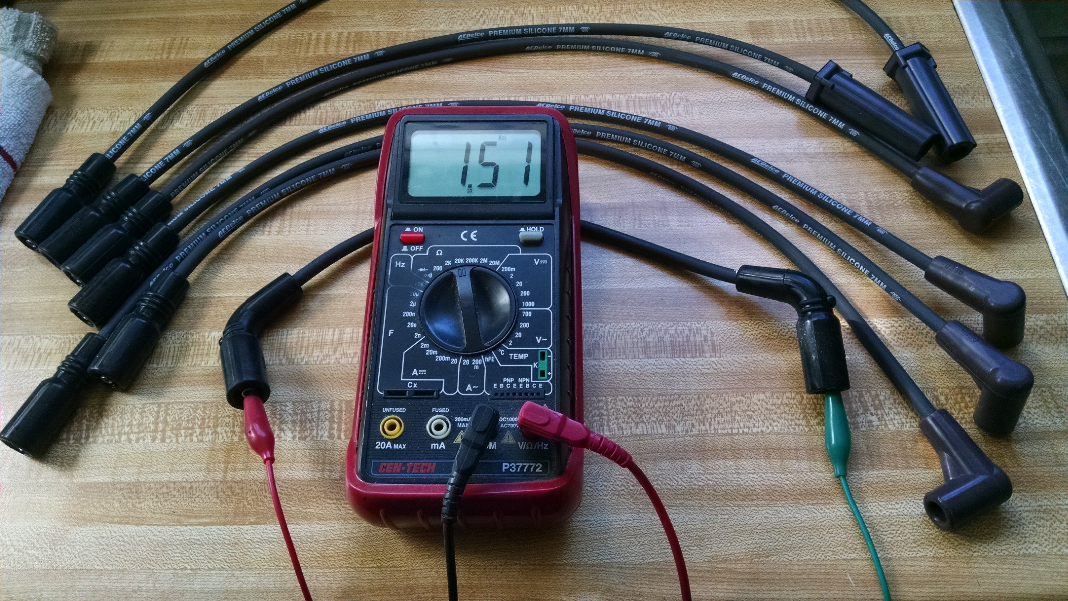

I owned a dual fuel propane / gasoline C-30 Chevrolet bucket truck back in the mid 80's. I got to know the conversion guys pretty good and they were adamant about using 8mm spiral core plug wires on their conversions. Low noise (spiral solid core wire) and more spark delivered. My spark problems was in a van that I have to remove the wheels and engine cover to access most anything on the engine. I used AC Delco OEM wires on this truck that is the coil wire pictured. Love the van, hate working on it.
