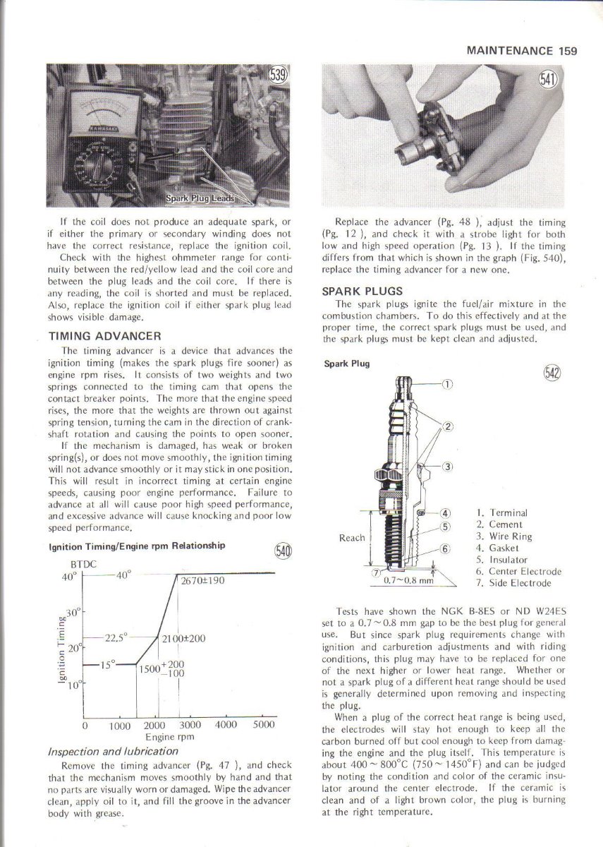

Re: 79 KZ400H1 slow to return to idle.
18 Aug 2018 13:11
Check your ignition timing and smoothly moving of your timing advancer , if not give him a little lube.

Thanks Scirocco ,
Did check the points and put the strobe on the advance, moved smoothly.
I'm kinda stumped on this one!
