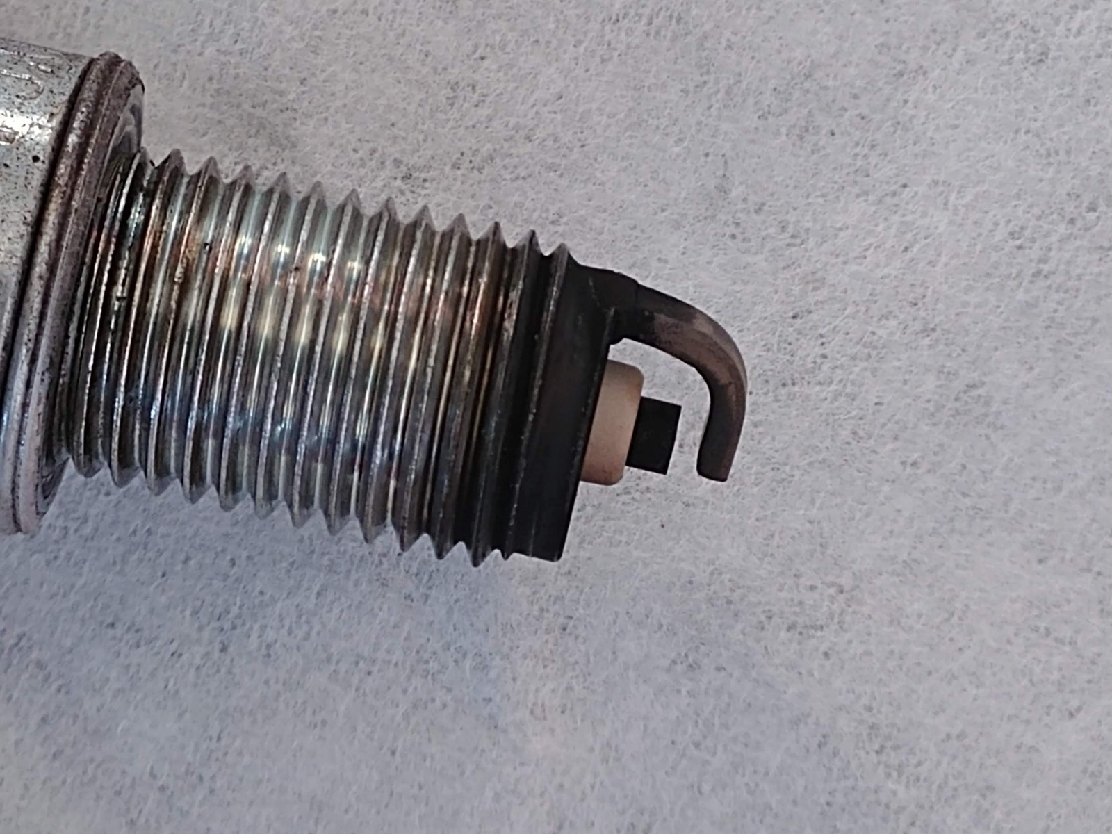

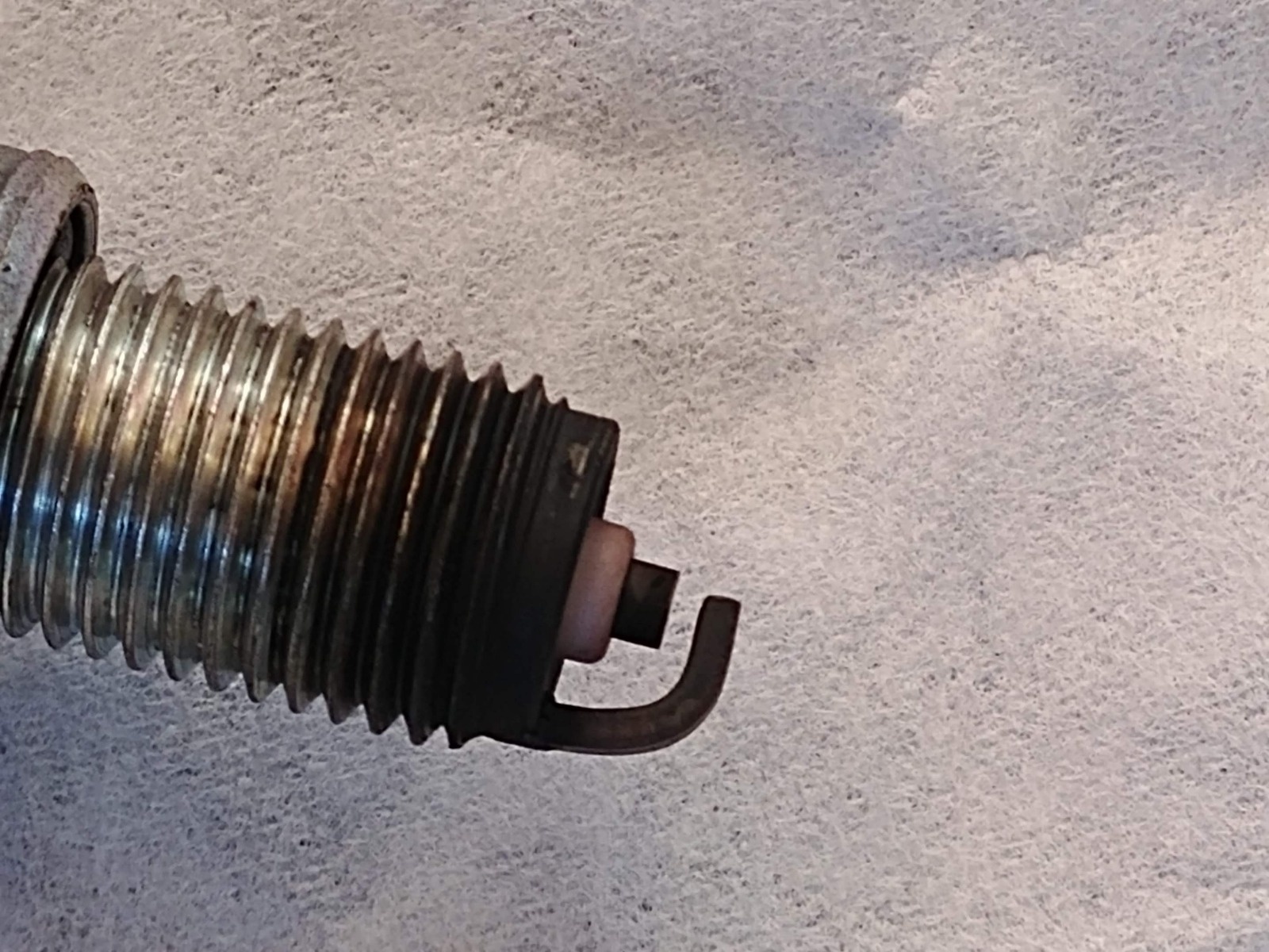

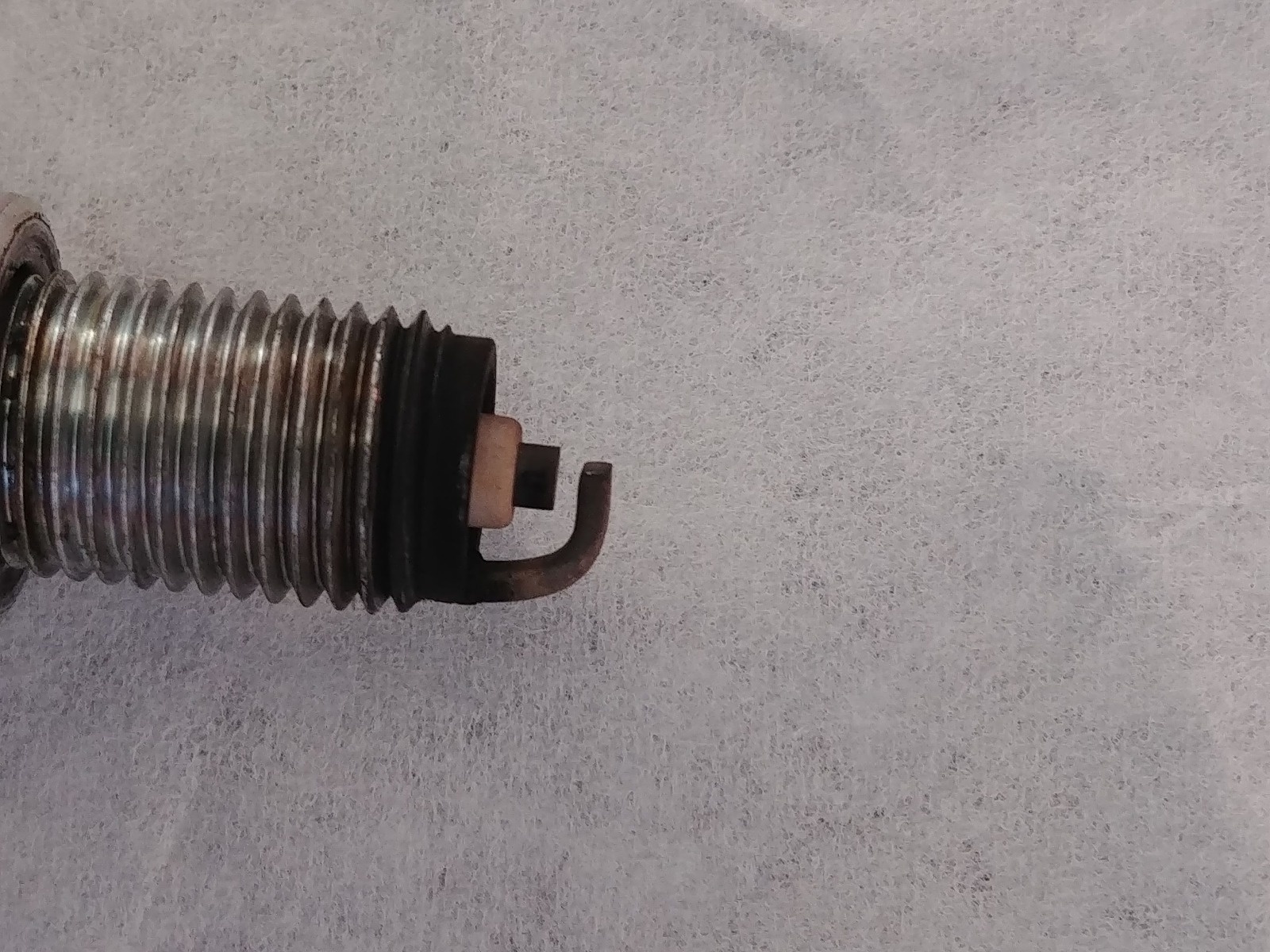

Re: gpz550 carb questions - stutter at 6k rpm
01 Sep 2018 18:15
finally... plug pics. I am not good at reading these but they look OK to me.

- loudhvx
- Posts: 10863
- Thanks: 1622
02 Sep 2018 09:02 - 02 Sep 2018 09:16
The problem with plug photos online is that the lighting and camera setting can influence how things look, as long as the plug colors are reasonably close to being normal. I can take a couple photos of the same plug and one will look rich while another will look lean if I change the lighting/settings.
If the plug is way off, like totally black or white, then it's easy, but when you are close it becomes increasingly difficult to say.
Another major issue is that one part of the carburetion can be lean while another is rich. So then how you drive it can influence how it look. If it's rich at idle, but you spend all your time on the highway, the plug may end up looking lean. Again, this is if things are close to being correct. If something is way off, then it becomes easier to see something is wrong.
To me, your plugs look pretty good, but some of the photos seem darker than others.
So this means you will likely have to do other things to diagnose your specific problems. Without an AFR gauge, you will need to use seat of pants.
The first thing is the idle. If you have an oscillating idle when the bike is fully warmed up, this still could be an air leak or choke issue. I know you don't want to hear that.
Another possibility is that for some reason you are idling a bit on the main circuits. This means the throttle is open just enough to start actuating the slides. As the slides go up and down, the mixture goes rich and lean. Since the slides are slow to react, this causes an oscillation.
I don't remember if you have pods or airbox. If you have pod filters, you can pull them and use a camera phone to see if the slides move during idle. They should not. Check all four. Do not try to look directly, up close, into the carbs while running. Make sure your face is not in the path of a backfire fuel/flame spray. I've seen 3-foot fuel/flame spray come out of carbs many times.
If the slides are moving at idle, then it could be the pilot circuits are plugged forcing you to use a bit of the main/intermediate circuits to idle. It could also be the pilots are too rich or too lean. If you idle for a while with no riding, the plugs might show you something. If they are wet with fuel, then it means the pilots are too rich or the choke is again not sealing off completely. There's probably many other possibilities I'm not thinking of, so hopefully some others will have some ideas.
You should have a system setup that allows you to see fuel level while idling on a perfectly level surface with the center-stand. You want to be able to verify fuel level quickly and easily, and get a lot of practice at it... eliminating bubbles etc. to get you a true reading. Its not as simple as the manual would have you believe. A hidden, trapped air bubble can throw your reading way off.
A really good thing to have is a stand with an auxiliary fuel can so you can run with the tank off. The aux can should not be higher than the fuel tank would be, but just high enough to gravity-feed the carbs. You will eventually need it for syncing anyway, so you might as well make it now and use it. It makes life much easier. There's probably a few threads with ideas on how to make them cheaply.
