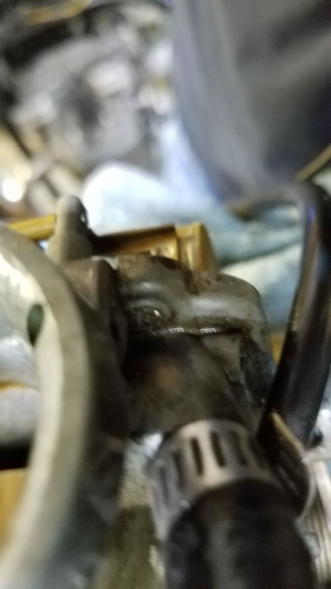

Here are some photos. I decided to take the easy way out and tap it with an American tap (8-32 i think)

Plenty of meat for a helicoil.

I'd say so.
