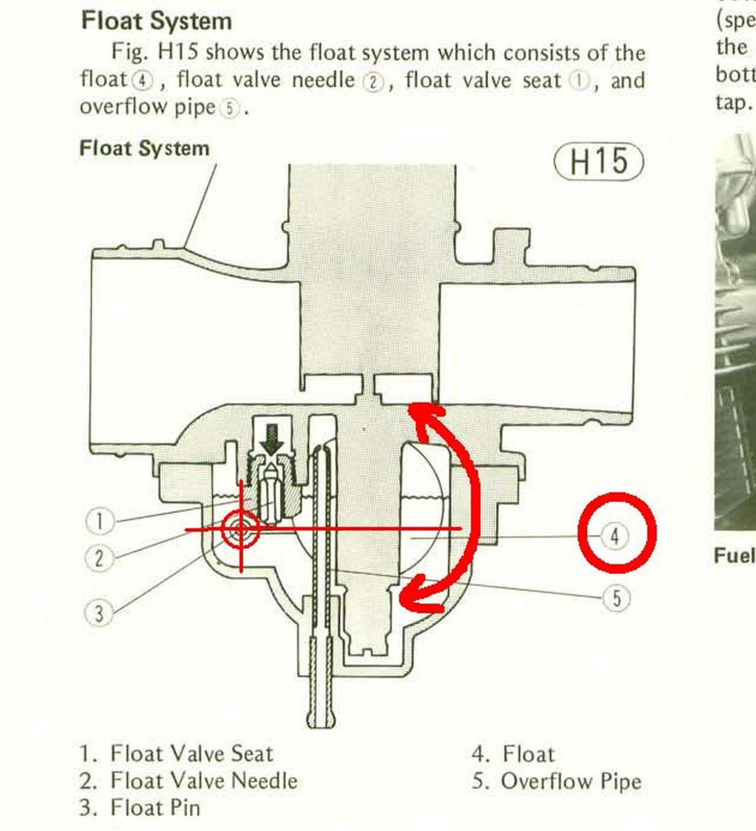

For shits and giggles I decided to check the fuel level in the float bowls using the clear tube method. 1,3 and 4 are perfect. #2 is dry. I have a sneaking suspicion I put that float back in upside down :pinch:
I’ll be taking them off again and I’ll fix the issue, bench sync, check the carb to head boots for cracks/leaks and re-install. I’ll update later.
Damn I feel like an ass.

I got everything back together. Sure enough the float in #2 carburetor was in wrong. I did a bench sync put it all back together and it fired up instantly. The vacuum sync shows I got it pretty close on the bench so in the morning I’ll finish tuning it up.
