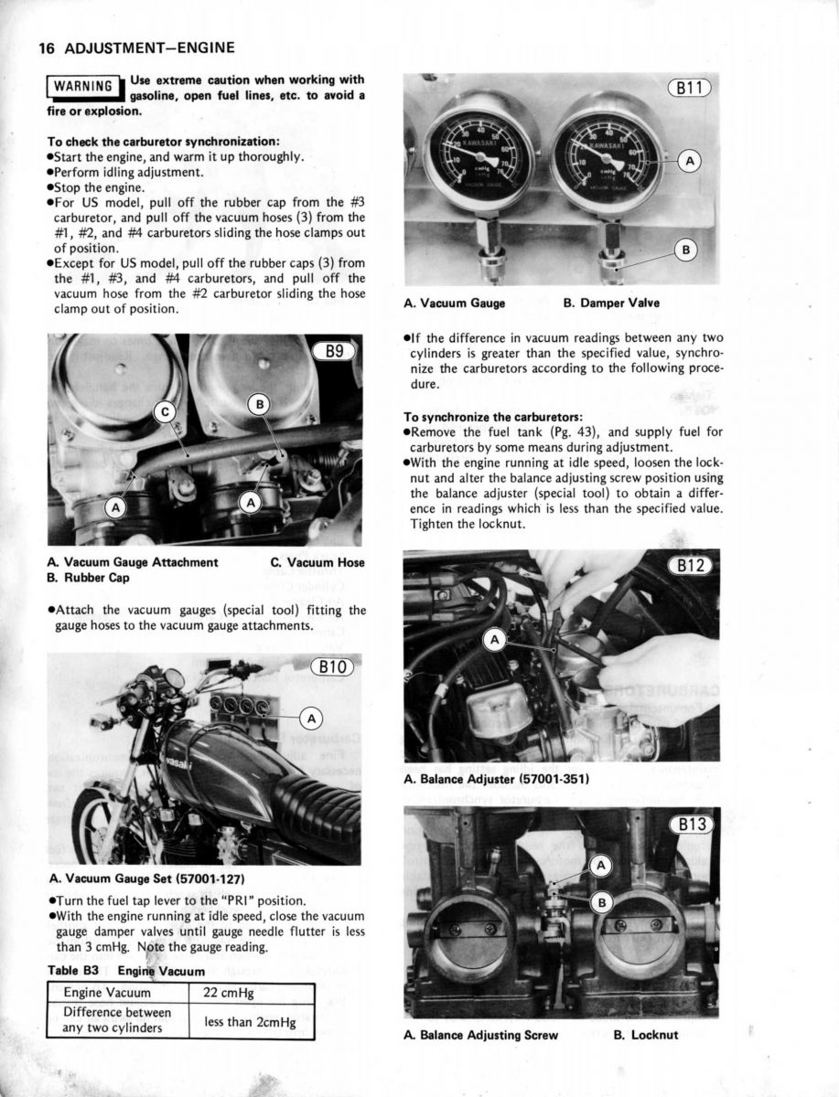

Hello! Yes I should have mentioned, I did synchronize them per the manual to the best of my abilities, and let me tell you, the bike runs very well and has plenty of power and throttle response is good apart from this idle-down issue. Thank you!
