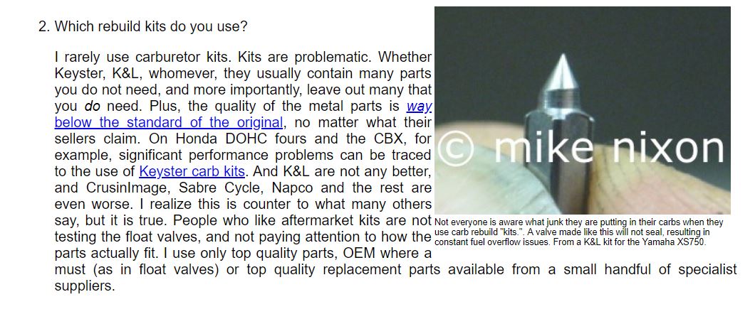

Sorry to bring this back up but found an interesting quote on a website from a Honda specialist regarding carb rebuild kits....
www.motorcycleproject.com/index.html
