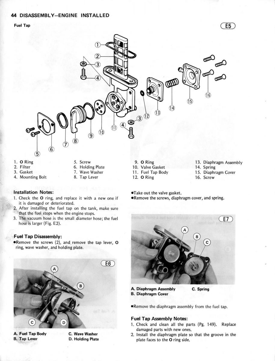

Can't remember since rebuilding my 750E fuelcock but you may be able to rotate that back cover. Gotta take it apart first to see though.
