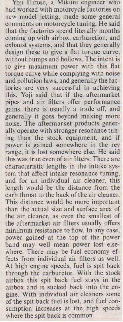

I agree, there must have been good reasons. Here's an article quoting a Mikuni engineer that I found interesting. Ed

I've told this story before but when back in school I had an XS400 Yamaha and no money for OEM air filters. Bought some cheap Uni pods but couldn't get the bike to run right. The XS400 used long intake runners with the air filters (2 of them) hidden behind the side covers. Wound up reinstalled the runners and clamping the pods onto the ends and then the bike ran great.

I had an xs400 too …same thing I put pods on it ran like crap. played with shiimming the needle and the pilot still nothing ,then put the pods on as you did with a piece of pvc, and it ran good. I think getting them in still air was as much help as the tube Although I think the oem may have been better. I had got it for my wife but she never really liked riding. That was a fun little bike I road the heck out of it.

Your bike will run better with the end section back on, i know this from experience, my existing thou was set up for performance and there was low end poor running, so i put back to stock aside from an aftermarket exhaust, and rejetted from that point, i now have a bike that runs clean my and smoothly right through the rev range.
