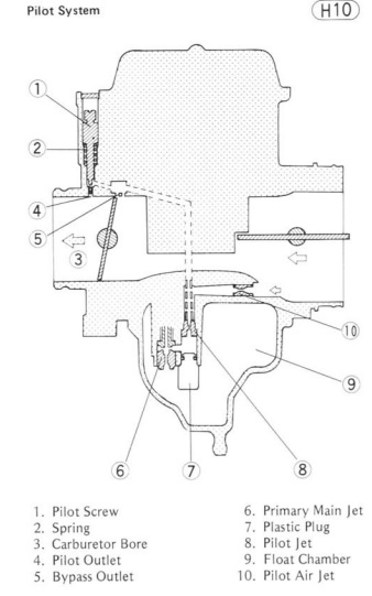

My suggestion would be a blockage at 5 in the diagram below. Pilot bypass and sometimes called transition holes. Important when going from idle up. I had a stutter one time at about 2500 rpm this was the cause.
You'll need to take the carbs off and operate the throttle linkage and get the throttle butterfly/flap to move and look for 3 tiny holes in the upper carb bore. I used a fine pin bent at 90 degrees or a guitar string to gently poke the holes.
You should be able to squirt carb cleaner in the pilot jet and see it come out at 5. If you have extra hand you could block at 6 and 10 while doing thisbut watch out as carb cleaner coming back at your eyes is very dangerous not to mention painful so wear safety glasses.
Good luck
Carb diagram taken from kz440 manual
Good luck
