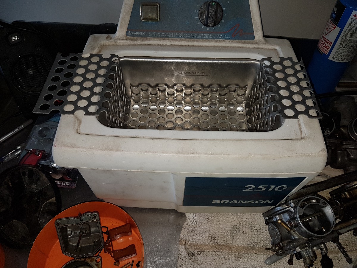

While at work on Friday I mentioned the sonic cleaner idea to the Foreman of the weld shop next to mine...he is a Harley guy but a good dude none the less...and surprise! They just happen to have a small heated unit in the store room that hasn't been used in years...better yet he lends it to me.
The cleaner is quite small an I know off the hop it isn't going to fit a full bank of bs34's or vm29's...however I just happen to have the perfect candidates to take a swim...

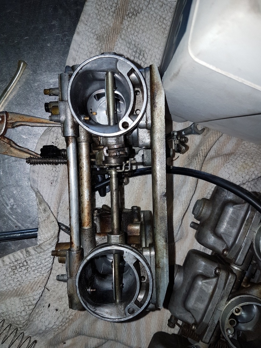

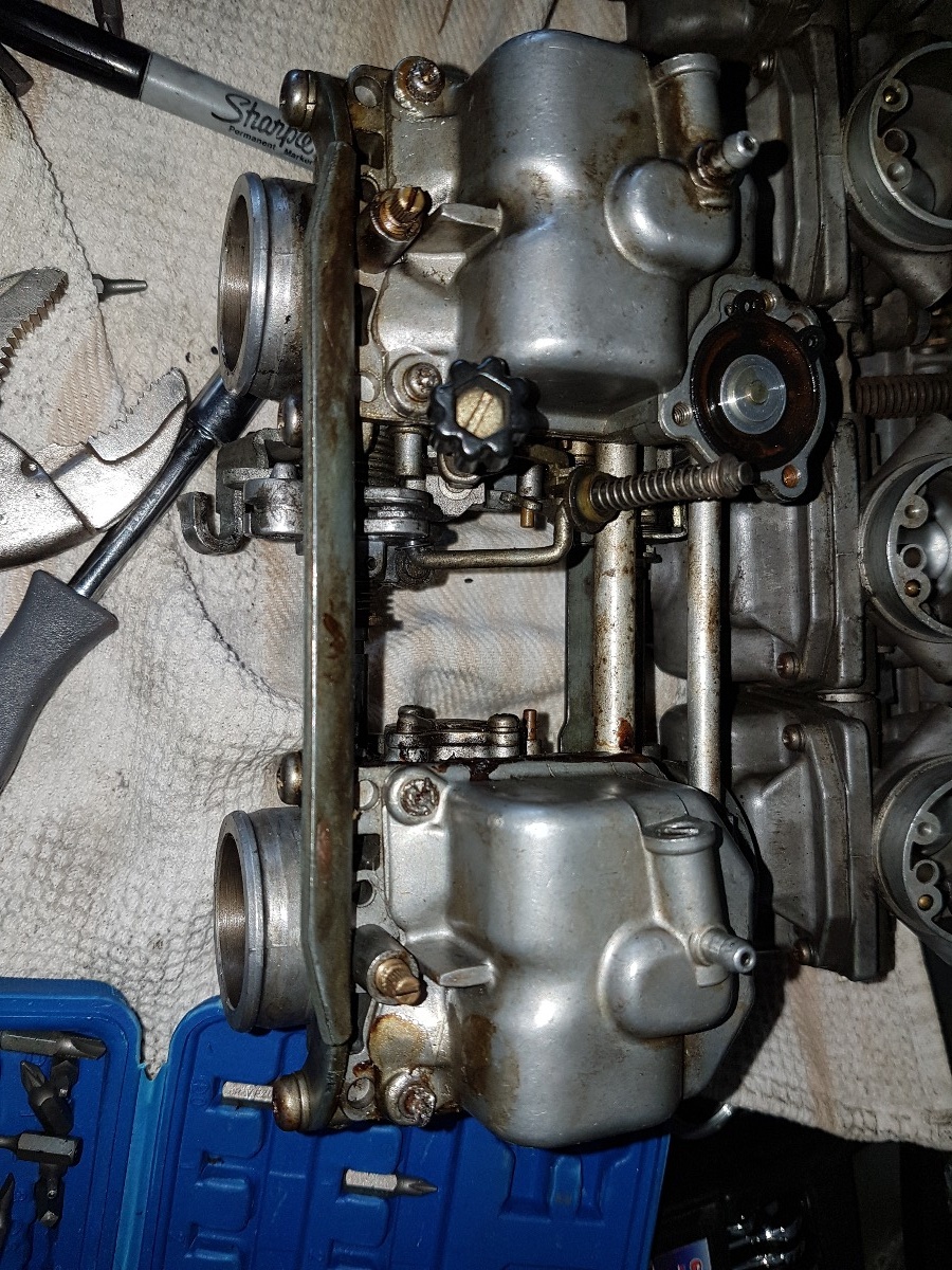

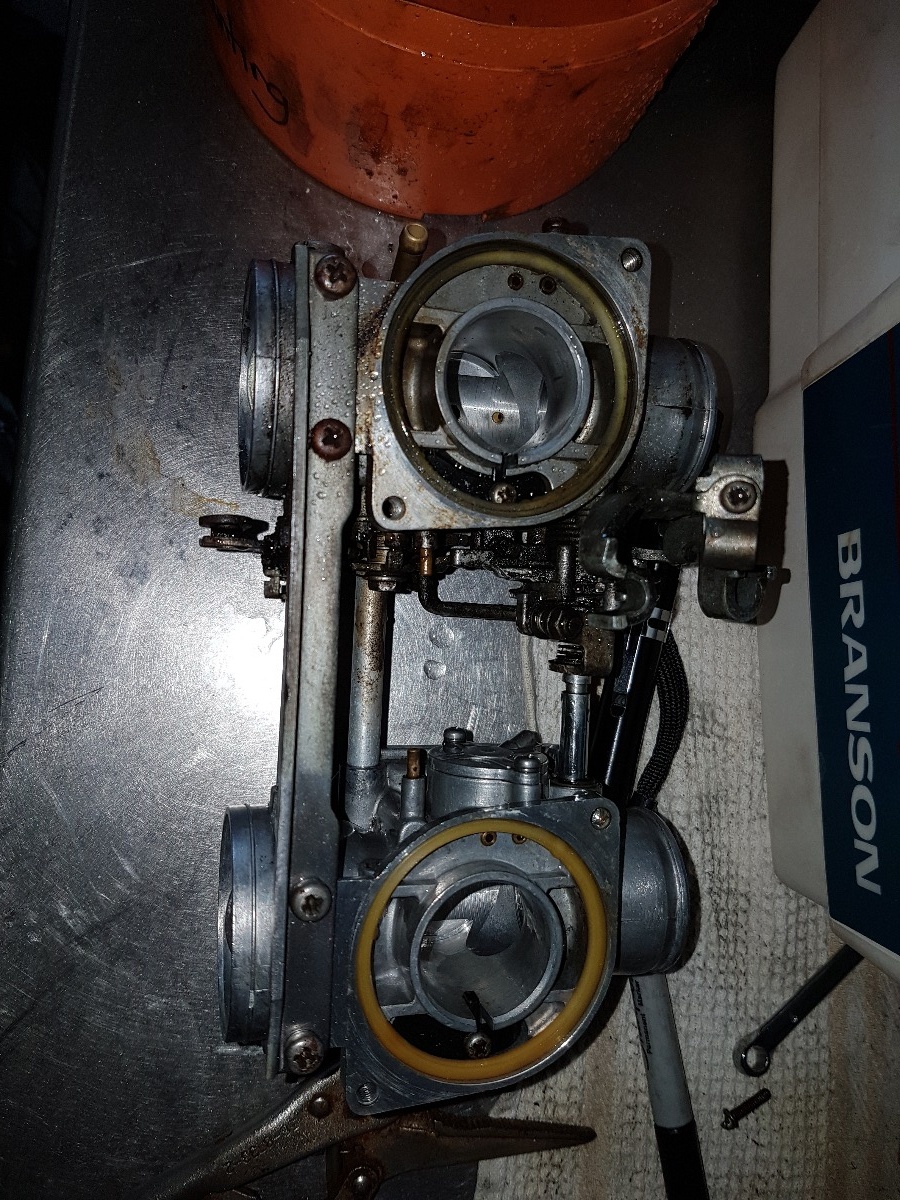

A pair of grimy old keihins off a cb400 should work as the perfect test mules..

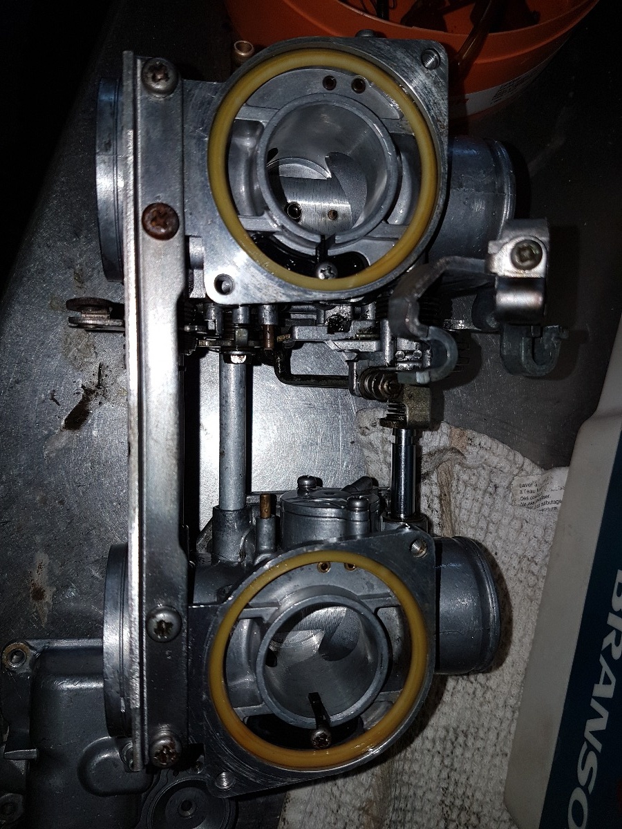

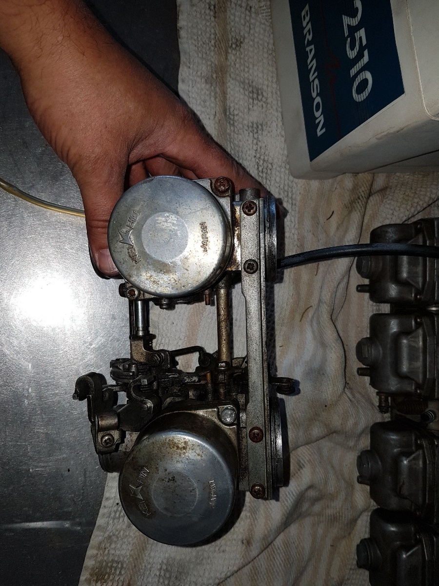

These should do nicely....
Now where is that pine sol...

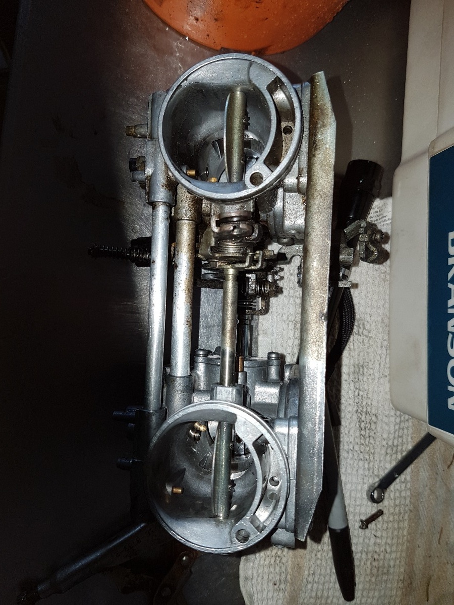

Hey...its small..i know
Can't be bothered to break them tho....and yes it's too full :silly:

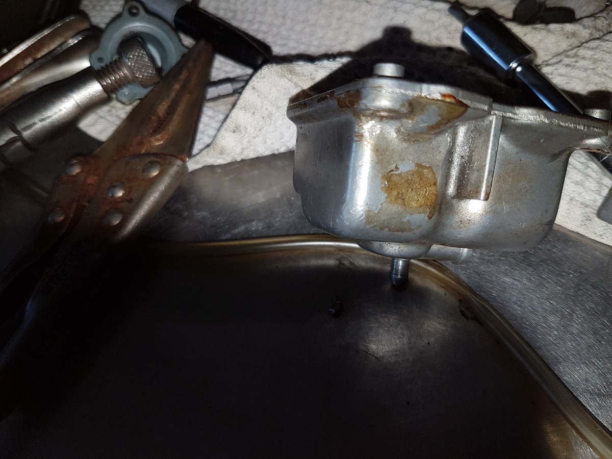

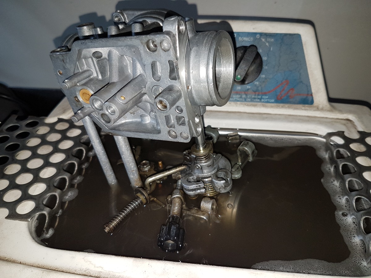

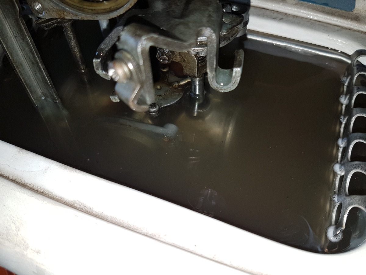

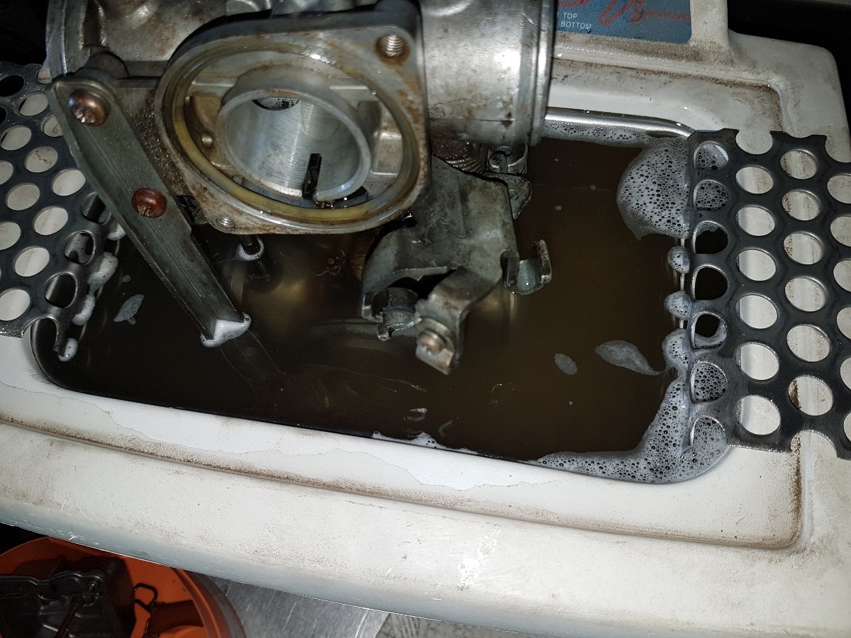

20 min in at 170ish°F.....solution is getting awful murky!
30 min cycle with 3:1 water to pinesol....

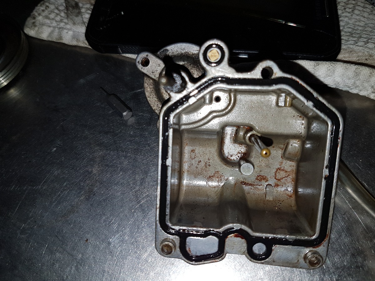

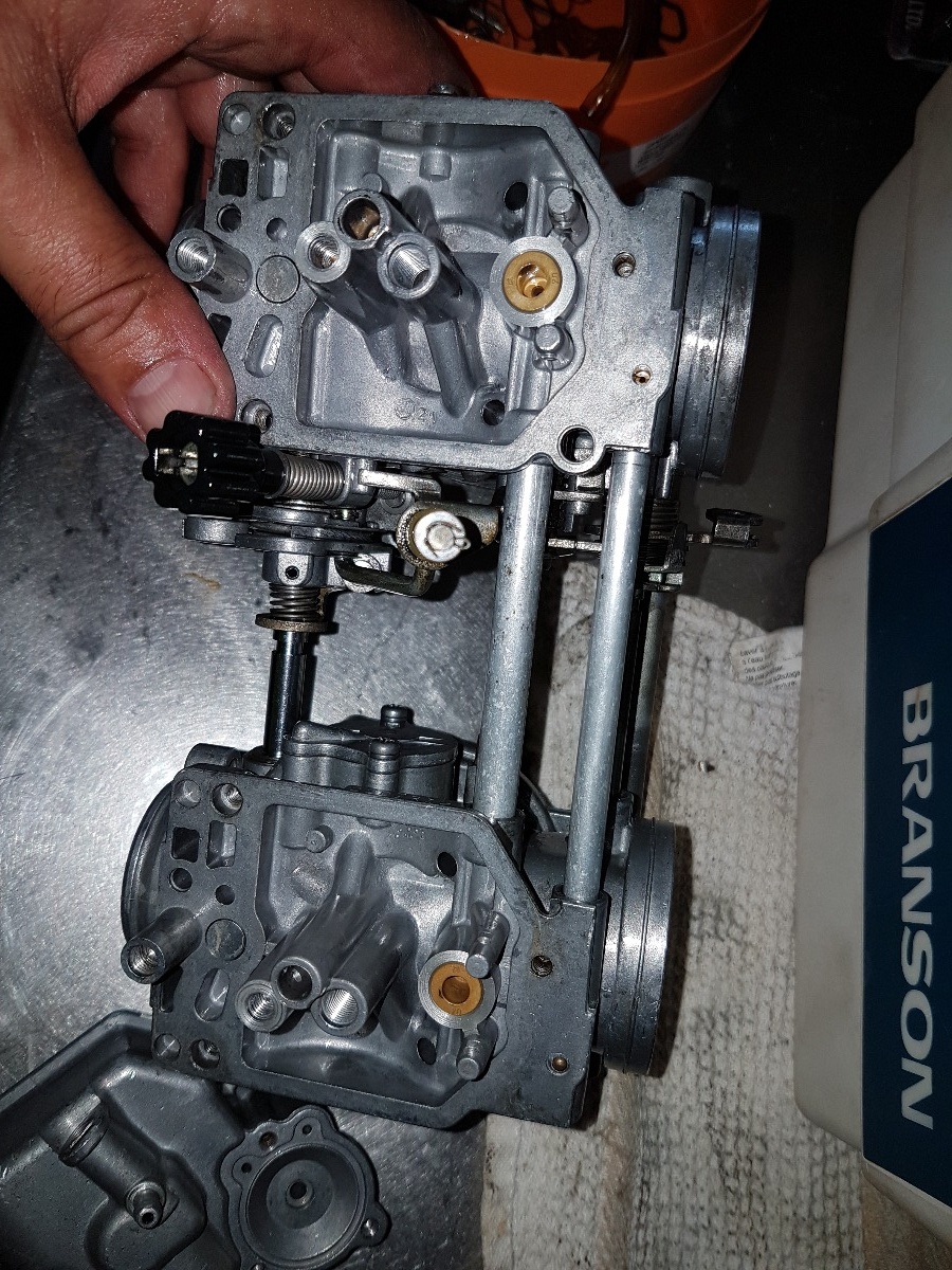

Defo improvement!
Flip em over and cycle again..

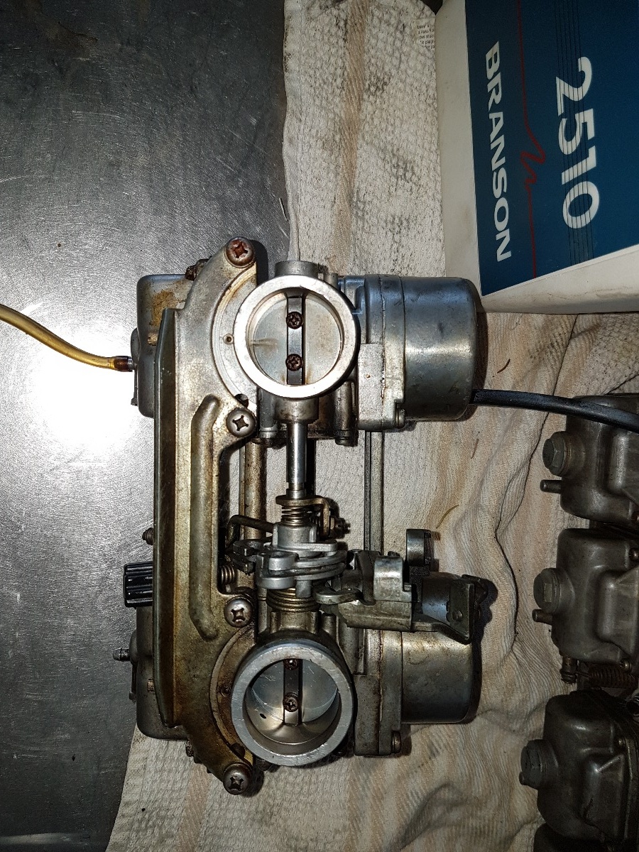

Just an fyi. pinesol no longer contains pine oil & it is a completely different product, so for guys without a parts cleaner it may not work as good as in some of the old youtube videos or forum topics.

Very minimal scrubbing with a tooth brush during cleaning...rinse with the garden hose...blow down with the compressor and a light spray/wipedown with old wizards piss (also known as water displacement recipe -40)...

martin_csr wrote: A few years ago pinesol was reformulated & no longer contains pine oil which is supposed to be a good solvent. There are store brands & non-name-brands that have pine oil in about the same ratio as the original pinesol. Pine-o-pine contains about 30% pine oil --- a much higher content than the old pinesol & the other brands.
Perhaps it's the glycolic acid that does the work?....or due to complaints they have re added pine oil to the "original" version...idk
It worked pretty damn well to my eyes.
Took off all the varnish and even the scorched on carbon with VERY light persuasion
