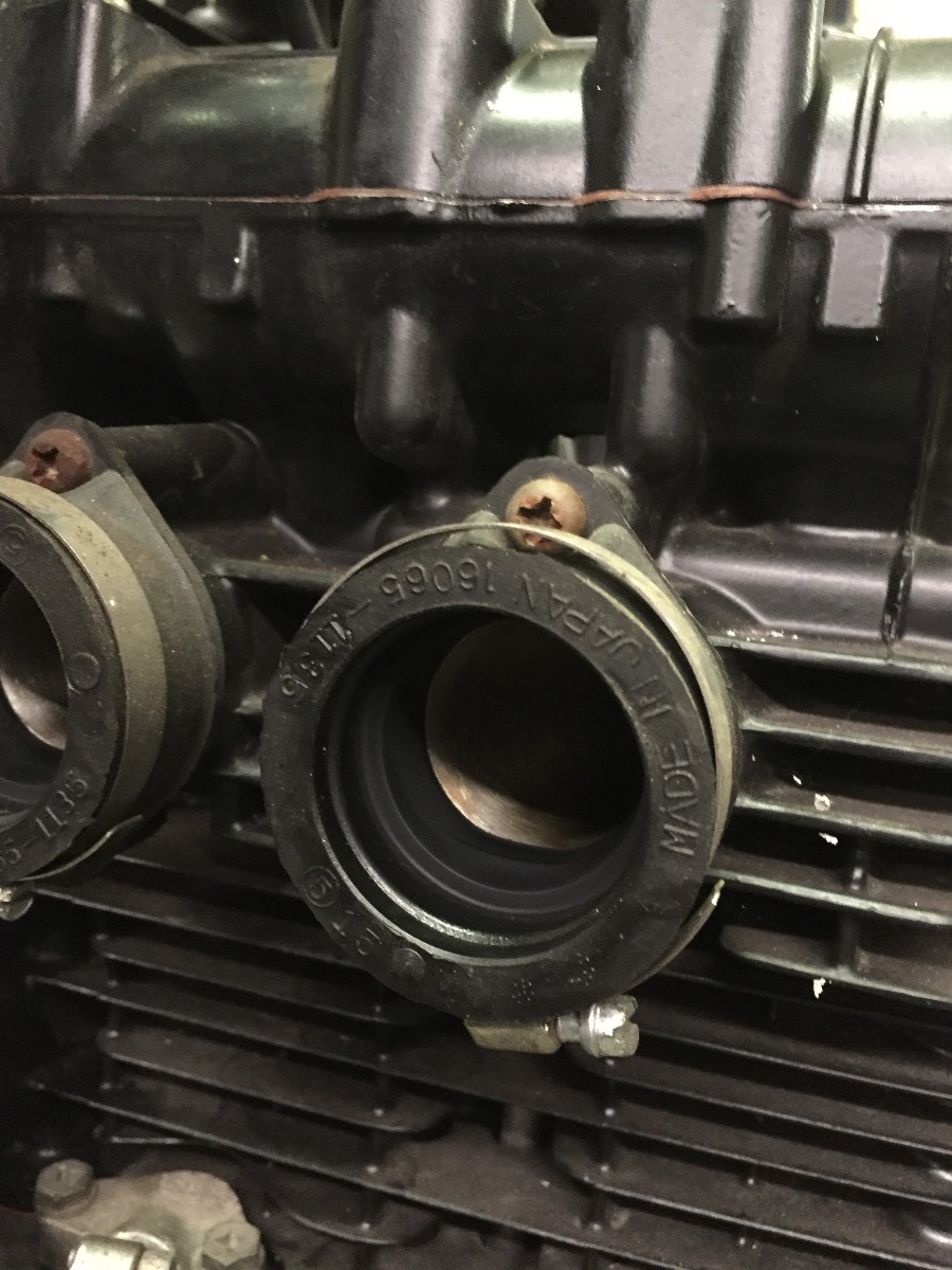

Hooked up the 4 gas analyzer last night. Idle was perfect. Off idle to about 1/4 throttle very lean. Everything else looked ok, possibly tad lean on top end. Hard to tell with no load on engine. Going up one size on pilot jet and one size on main... then recheck. Checked the sync. Was off a little bit. Did the steel ball test. Now they all fall
Out the same time.

not sure why it posted that one pic so many times???not sure now to remove all the extra ones?

TwoCam wrote: not sure why it posted that one pic so many times???not sure now to remove all the extra ones?
In the edit box, click behind each attachment line you want to delete, then back-space that line away. Just leave one of them alone, and click submit.
