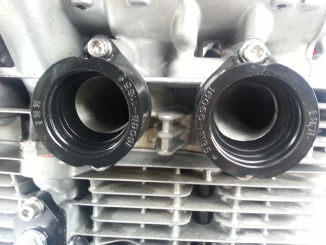

Well, I received the new clamps and reinstalled the carbs. I used a small amount of silicone grease to allow the carbs to slip in the boots easier. I started it up and vacuum leak is worse than ever. I don't understand it, all the parts are new. I really need some suggestions.

Well, today I sprayed some wd-40 around the boots and found the vacuum leaks. I don't know where to go from here. The carb boots are brand new.

I may have installed the wrong boots. It looks like there's two versions of boots available for 34mm carbs. I'm not sure which one to order. My carbs are BS34ss.

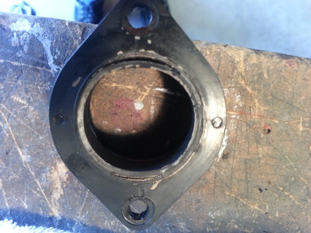

Today, I removed the boots and found that the rubber had separated from the flange on 3 of the boots. I think this is my problem. Does anyone have any suggestions on repairing the boots? or should I just order new ones?

Replace them. If you try to repair them you will be spending countless hours going over them again and again. Ed

They look new from the outside but the first pic says otherwise. They should have conformed to the intakes. I'd buy new ones.

Thanks guys! Yes, they are new, but they didn't last long.

Are you running the stock airbox? If not, the weight of the carbs hanging on the carb holders may have hastened the damage. I'm just imagining the shot they take every time the bike hits a bump and the carbs try to bounce down and up. Ed
