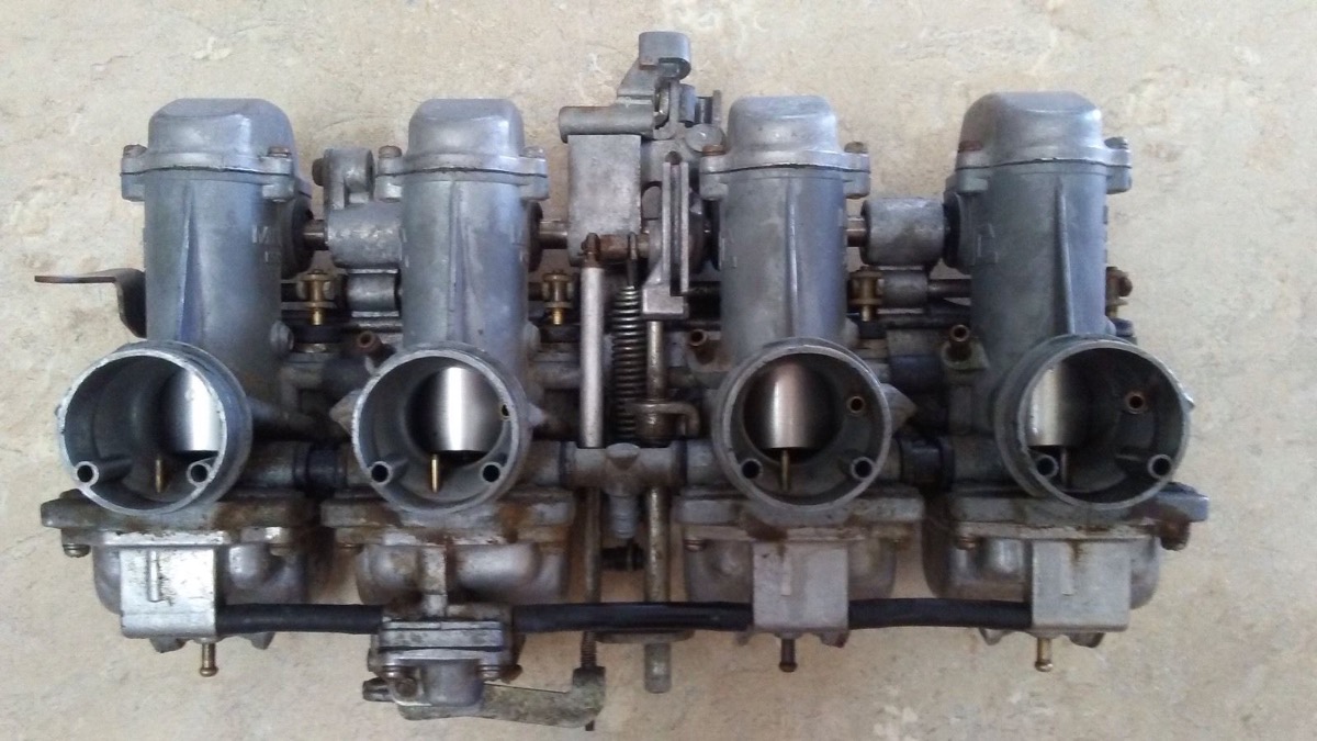

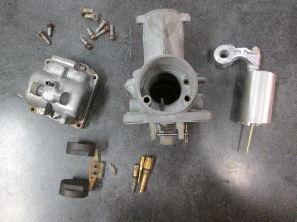

I have a set of 28mm mikuni accelarator pump carbs. that I have totally cleaned and rebuilt. They have a 2.0 Throttle Valve. I'm going to use these carbs. on my 77' KZ1000A I'm preparing for motor rebuild which will be with a 1075 kit and so on ( ported heads and cams , etc. ).
My stock 26mm carbs. on my KZ have 1.5 Throttle Valves.
Would there be any Benefit to swap out the 28 throttle valves to the 26 throttle valves ?
Just brainstorming you guys who know so much more than I.

I would. They'll run lean otherwise. Compare the needle jets, needles and emulsion tubes too.

I haven't jetted these 28 carbs. yet. Not until I get the motor rebuilt. Have a person close by me that Neissem recommended to rebuild motor and have talked to him.
So if I can rob parts off my 26's ( emulsion tubes and needles )that will give the 28's better performance, I'm down with that. It will be interesting to compare them.
