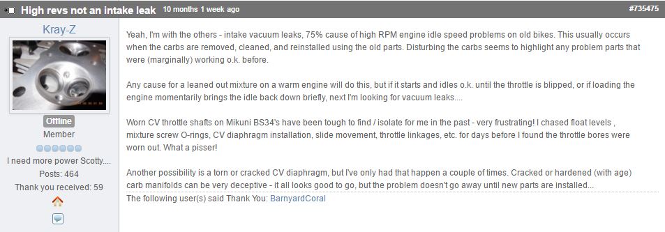

27 May 2017 16:23 - 27 May 2017 16:24BarnyardCoral wrote: How many of those potential air leaks would result in a 4k rpm idle? I suppose it's easy enough to identify if there's air leaks, less easy to identify if those leaks are causing the wonky idle speed, oui?
Any of them can cause this. They are not always so easy to find as you may think. If the carb holders are stiff or cracked, they are probably toast.
Definitely check the timing advancer for easy movement. Don't need any fuel for that.
