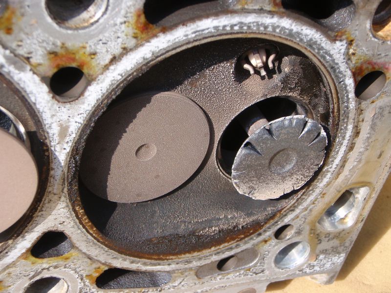

Re: 1981 KZ440LTD Left carb giving me fits.
17 Jun 2017 14:31
Do a compression test.
Looks like a burnt or bent valve
A not proper valve to valve seat surface and a too tight valve clearance are the reasons why his happens.
