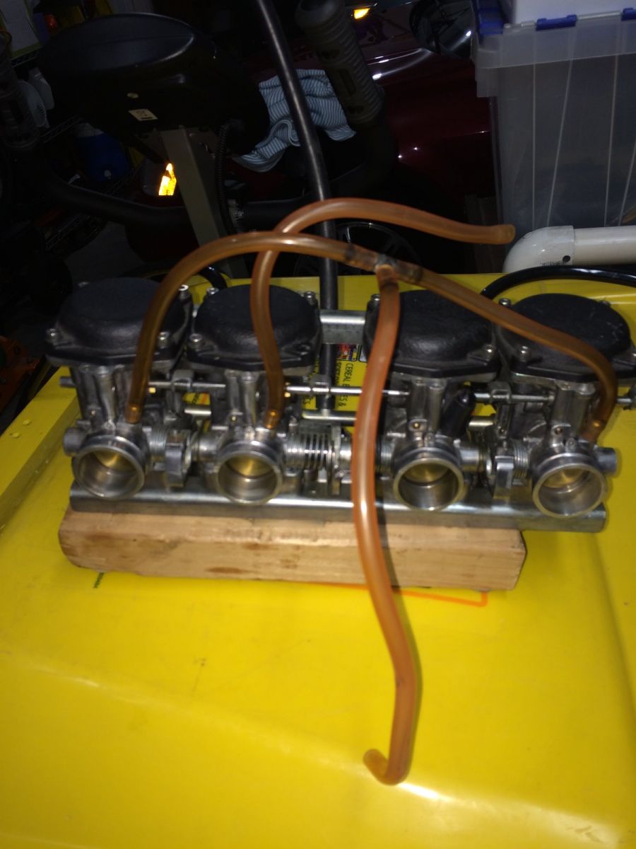

Here is a picture of my carbs with the vacuum lines attached. Carbs 1 and 4 are linked together by a T fitting that attaches to the vacuum switch valve. Carb 2 vacuum line goes to the petcock. Carb 3 vacuum fitting is capped. Any problem with that arrangement? Also, if I get rid of the vacuum switch valve, can I just cap Carbs 1 & 4 as well??

Yes

Carbs are numbered left to right. Looks like petcock vacuum is coming off #3 and #2 is capped.

Agreed the numbering is reversed in my post as the photo is of the side connected to the engine. Question - can you get rid of all the vacuum lines other than the one connected to the petcock - and does it matter which carb vacuum line is connected to the petcock?

29 Apr 2017 17:01As Texas KZ said, "yes", you can get rid of those two vacuum line and cap them off.NDSpectre wrote: Agreed the numbering is reversed in my post as the photo is of the side connected to the engine. Question - can you get rid of all the vacuum lines other than the one connected to the petcock - and does it matter which carb vacuum line is connected to the petcock?
It does not matter which cylinder controls the petcock.
