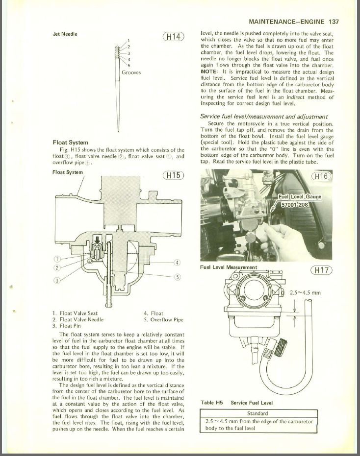

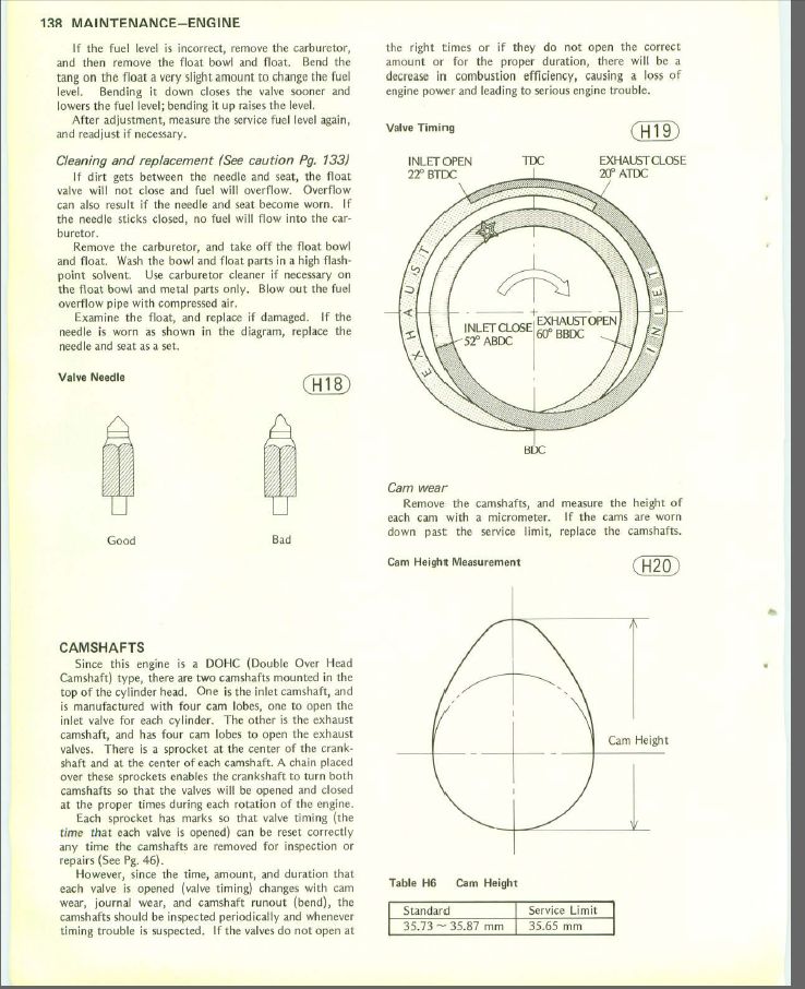

have you checked the needle valve (surface ) and needle seat, plus float bowl high???
maybe you have bent the tap of the swim body (adjust the float bowl high ) or the valve needle spring in
the valve needle body ( no movement )
or the valve needle it self is stuck in the valve seat.
Michael
