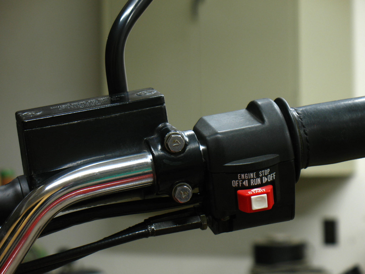

flhwesty wrote: I have a ProMotion throttle. I am running 29s using only one cable. Think I have an extra cable.
I found this Kawasaki dual-cable throttle control on ebay. Otherwise identical to the stock single-cable unit, it works beautifully with the RS34's installed on my bike. Had to swap over the wiring harness, but the fun part was fabricating two functional throttle cables with various components from four. :)
