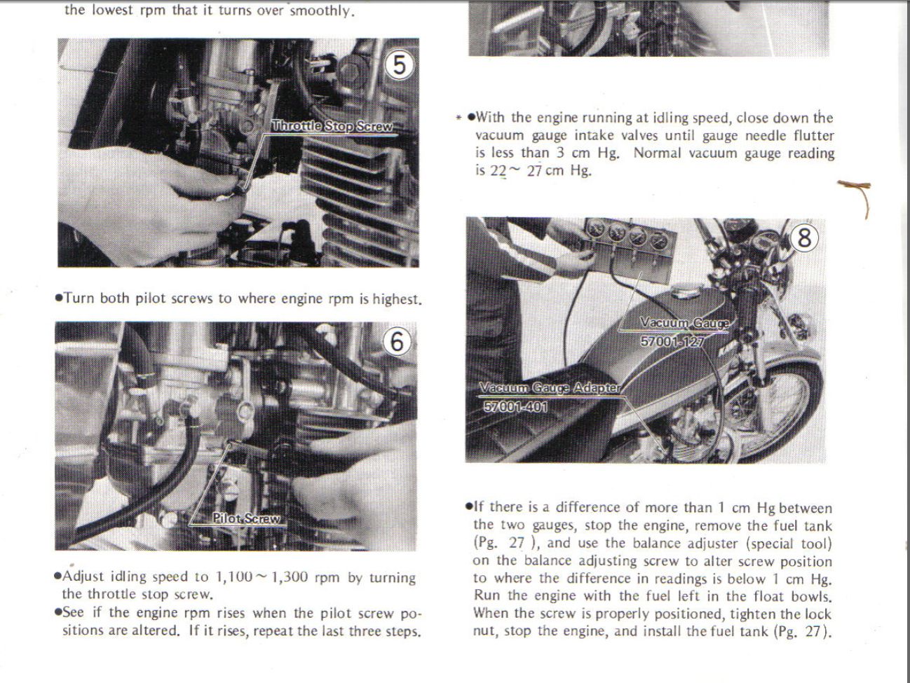

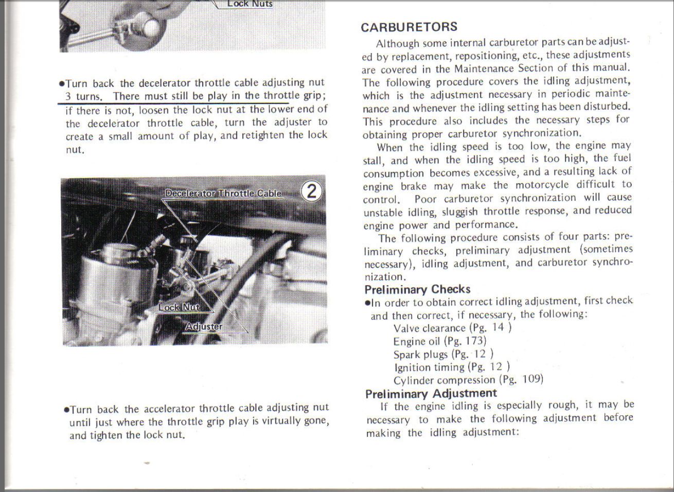

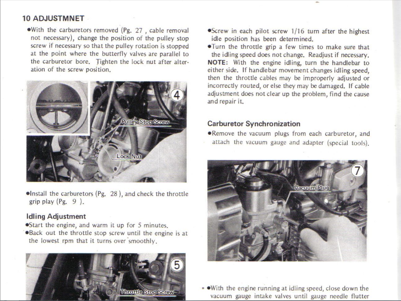

Hello kyan44
What do you mean with when you say "my new mikunis VM30's"? Have you rebuild them by your self?
Are the carburetors synchronized?
Intake boots with no air leaks?
Float bowl high correct?
Air screws set to reference?
Air filter and housing stock or K&N?
Ignition timing ok, correct gap on pointer(dwell)?
Get the full services and repair manual
www.manualedereparatie.info/manuale/Kawa...dereparatie.info.zip

I haven't synchronized it yet. That's what I was trying to do. For the intake boots, how do I check for air leaks? How do increase idle stop?

Spray brake cleaner on the intake boots. If the engine revs different as usual (mostly lower) you have an air leak there.
Pic“s are out of th service manual in my first posting. Get it.
