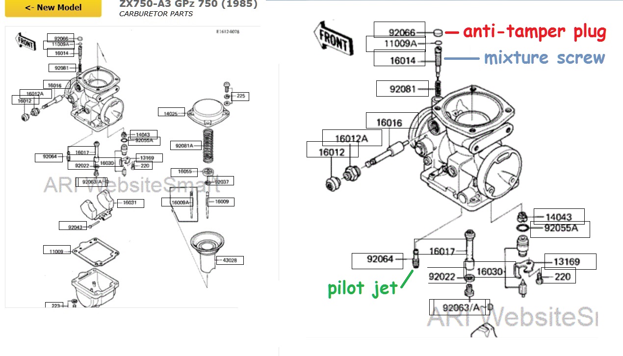

Am uncertain of the "bung" that's being referred to.
Here's a link to what's supposed to be the parts diagram of a stock carb on the 1985 KZ750 GPZ:
www.powersportswarehouse.com/p/Kawasaki#...0-A3-1985/080186C-10
This particular diagram doesn't show a plug for the pilot jet.
The pilot adjustment screw is shown as having an anti-tamper plug (which plugs are often removed and discarded by owners in order to easily access and adjust the pilot mixture.
As referenced by Nessism, the carbs at hand may be of the style that does have a plug or cap over the lower end of the pilot jet (not pilot screw).
If the carbs at hand are different from the carb shown in the above diagram, I'll defer to Nessism's expertise as to being a style that includes a plug or cap over the lower end of the pilot jet, in which event the cap or plug should be fitted (as shown below).

I'm backpedaling a little here since the parts fishe doesn't show the pilot jet plug. I thought all BS CV Mikuni's used the plug. I suppose it's possible that the plug was discontinued, but there isn't any mention of that in the factory service manual.
