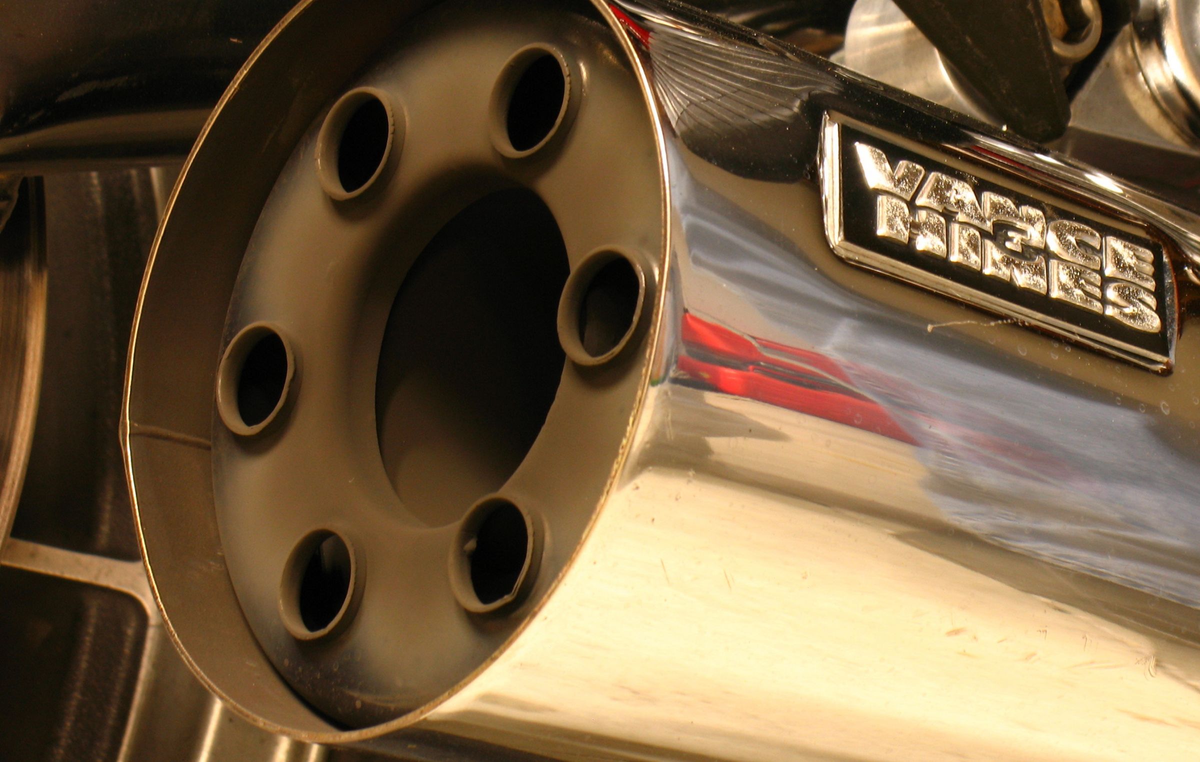

I bolted in the competition baffle for the first time since changing carbs. Its louder than the street baffle, but there is a significant difference how quick the bike moves.
Idle is very smooth with the jetting installed with the street baffle. There is no deceleration pop with 20 pilot jets, and I still get a slight hesitation bog with the 140 (one-forty) main jets, but that hesitation has steadily diminished with each larger main jet installed. The needles are clipped in the center slot.

DaveO,
Are you like a professional photographer or something? This picture is freakin' perfect. I thought at first it was some advertisement from a magazine you found about your exhaust on a KZ!
Great work on the bike and for noodling out the jetting details!

No pro bro, but/and thanks for the complement. :blush:
I have an old Canon A630 digital camera that is addicted to capturing good images.
A tripod is essential.

Fixed the knarp situation.
Back to .8 pilot air jets. The engine definitely likes that size.
Here's a pic of the tail pipe/baffle that has tan color never seen with the BS34's. The competition baffle was completely-clean a few days ago,
and how it is now:

Looks good.

I want to say FINALLY with a sigh of relief, but I know better.
What is that fine-tan deposit? I can't see a trace of black soot in it, even at 300% zoom.
Just use Shell Regular gas, if that has anything to do with it.
