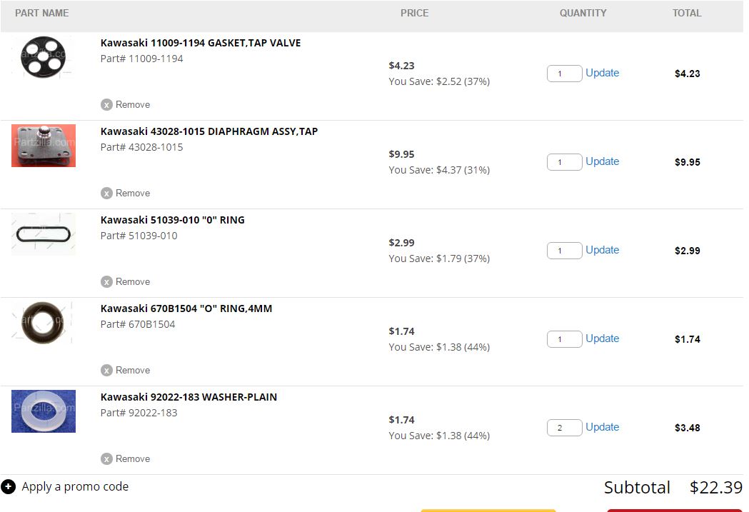

Get that spring that Ed linked from ebay and everything else from your favorite dealership source: Diaphragm, O-ring, tap valve gasket/seal, drain bolt gasket, and don't forget new seals for the screws and a new main petcock seal. Renew all the rubber in other words.

Gentlemen, Thank you all! Everyone of you i had hoped to hear from and you never let me down. So high fives all around!
Ed, I managed to order that elusive spring just now and even on this little screen. There's hope yet for my online shopping prowess (or current lack of as the case may be :laugh: ).
Ness, I'll get the rest of the rebuild parts you said tonight at home where i can actually see what i'm doing.
