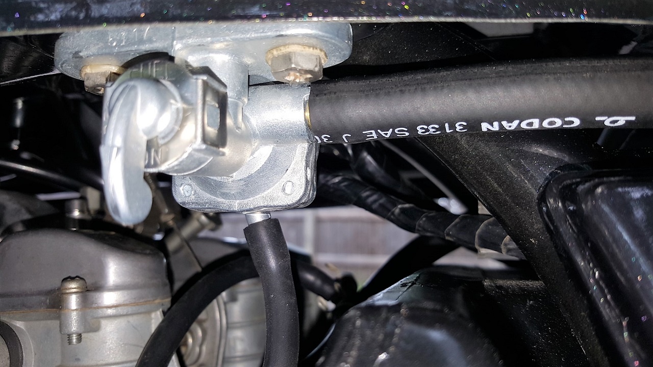

I got the new Suzi petcock installed on the tank today:
It required the inside vacuum port be rotated 90 degrees to the downward position as it interfered with the frame during installation (although, once in position, it wouldn't be in contact with the frame; you just couldn't remove the tank. LOL).
Also, I rerouted my fuel line to avoid kinking it as the fuel port sticks straight backward and you can see in the pic how close it is to the frame and even the side cover panel.
I still haven't yet fired-up the engine (but I'm ->this close<- now) so I cannot report on the petcock's functionality but it does have Prime and Reserve positions in addition to the normal on position just like the original Kawasaki petcock so I don't expect any drama.

Dang wrench I forgot that I had to rotate the vac plate too but anyway like you said was easy enough to do.... thanks for the tip Pete too on the filter but to be honest the way we did it works great.

That sucks. If were me, I'd take out the nipple and drill the other side. I'd tap and plug the original hole. How long is the fuel line this way?

Wrench- could you take a farther away shot on the tap side of the tank so I could see how you routed the line in?

Yes, Nhanc3d it is a great solution and it does look good - smaller "face" on the unit is cleaner but same same operationally.
So Thank you for the suggestion.
I have the tank off now while I attempting her first engine run but I can tell you this - that fuel line could probably be bent down and inward directly from the petcock without kinking the fuel line. I was thinking of putting a fuel filter directly after the petcock as my tank was super rusty inside. I wanted easy access to both the line and filter for checking. I dunno how many of you have tried to peek down at the carb space between the petcock and fuel rail but it's anything but easy access. But lifting the seat and having sight and access... 'Natch!
Thus, the idea to run the fuel line straight back, under the seat and curved around, following the radius of the air breather lid and back through the frame/plastic plate (I dunno what that small plastic plate is for? To hold air box down in place?).
I'll take more pictures Devin, when I get so far as running engine off the tank instead of on the bottle.
Steve. Is there a problem with having a longer fuel hose between the tank and engine? I mean, for me, it's about easy access for checking the filter and replacing it without struggling in a confined, hard to see, space but I didn't guess that would introduce problems by being too long...

Personally I think this works out perfect... I have a 2 inch piece coming off the carbs then the filter and curve a 8 or 9 inch piece around and down into the filter..... nice and neat gentle angle down for good flow, kink free and very easy to get too.

I don't think it would be a problem. I was thinking out loud. Thought you have the nipple from the old one you could use to adapt it to the other side. If you like it, that's all that matters.
