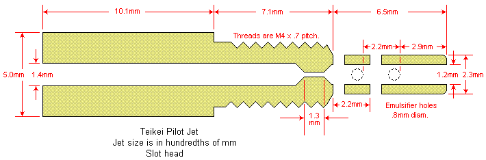

If your pilots are drilled to a #63 bit, that is like a .94 mm size jet. Stock is .32mm. So your pilots are way too big. The main jet started as a 92, so it's even bigger than the stock main jet.
It's possible you are actually idling on the the main circuit, but either way, you will need new pilots to get the jetting correct.
Just curious... you mentioned capacitors. What are you referring to?

You need to get a baseline list of what size jets you have, and what needles you have. Are the needles adjustable? If so, are they marked with a part code? Some Chinese knock-off kits have non-usable needles.
If the bike ran perfect when you bought it, what have you changed since then?
It's hard to believe the bike ran perfect with pilots drilled to .94mm. I never go above .37mm, and that's on a gpz.
Are you sure you are measuring the skinny part of the jet orifice?
