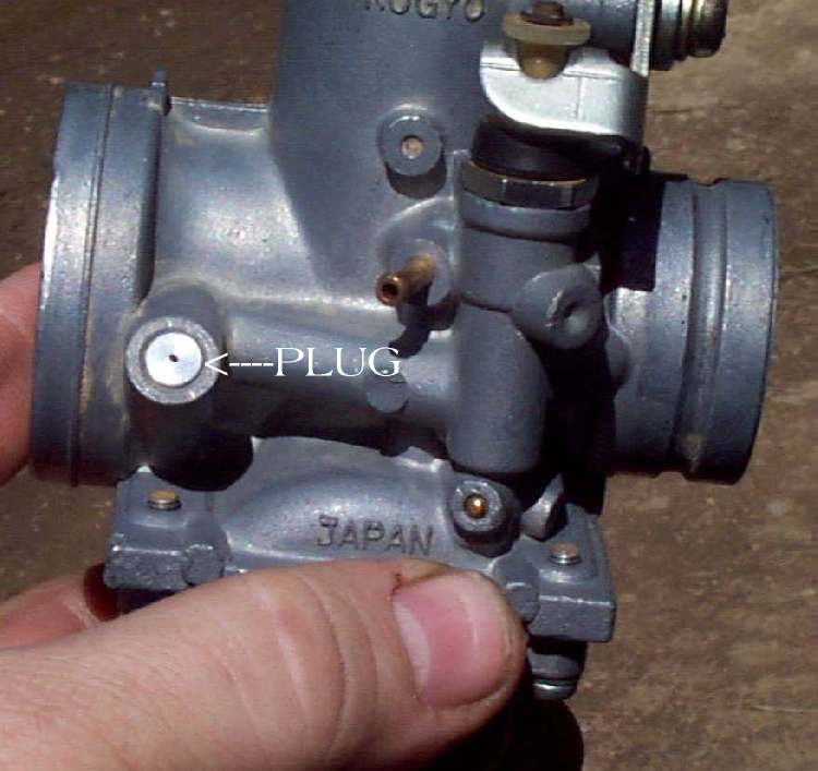

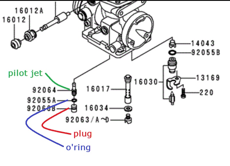

Be sure not to confuse the non-essential externally visible "non-tamper" plug (covering the pilot adjustment screw) with the required internal plug that prevents fuel entry into the otherwise exposed end of the pilot jet.
Non-tamper plug over pilot screw
Required internal plug over pilot jet
