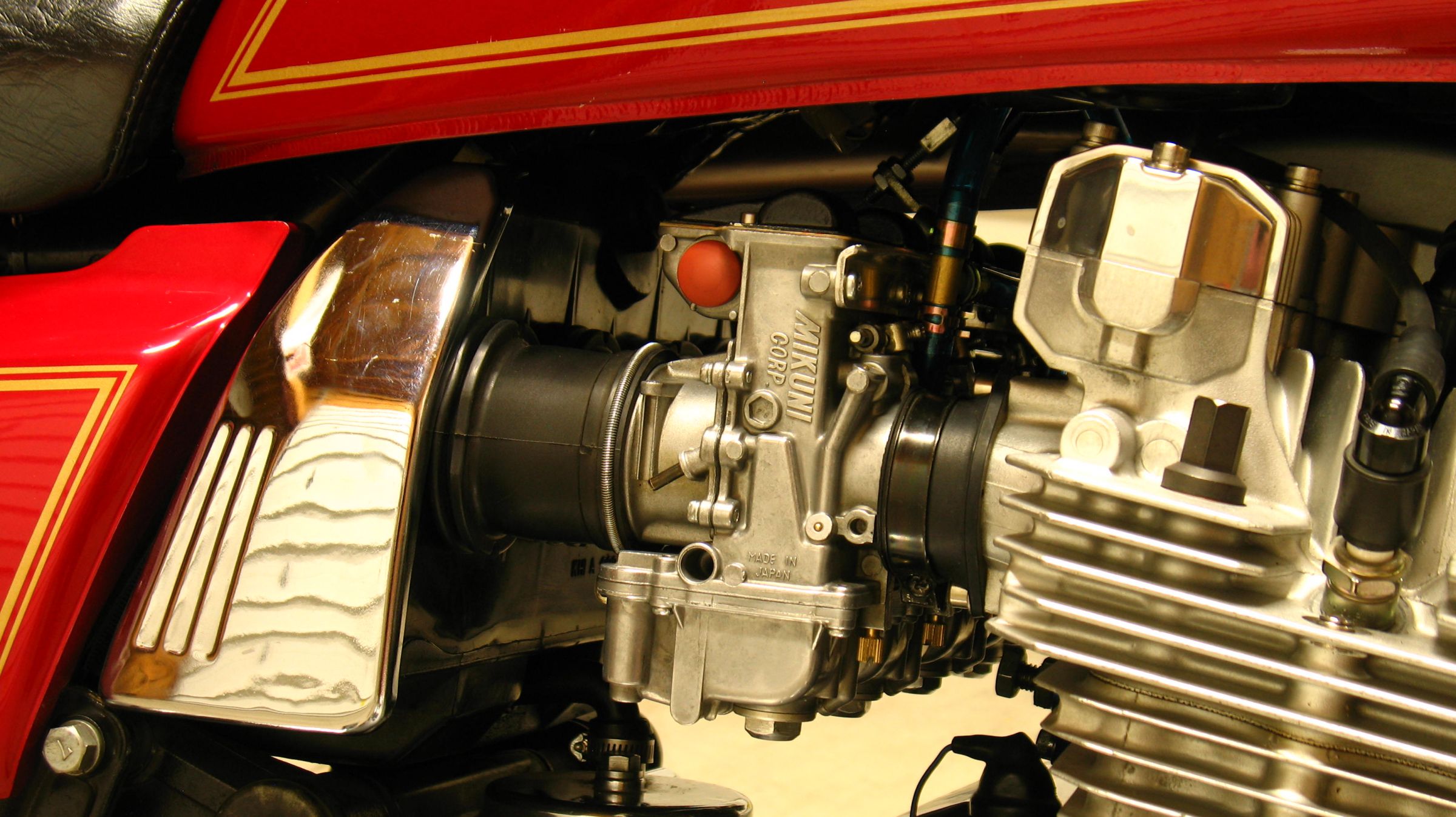

Yes sir, the air box proves this is not a race bike. :lol:
...and those rubber boots are not disguised velocity stacks, either.

- Posts: 23604
- Thanks: 2980
Re: RS FlatSlide accelerator pump
11 May 2016 08:01
Looks like they're outside the air box. Too short?
- daveo
- Posts: 3063
- Thanks: 817
11 May 2016 08:31swest wrote: Looks like they're outside the air box. Too short?
The boots were moved out/forward to fit, because the RS carbs are 3/8"shorter (front to back) than the BS34 carbs the boots were designed for. The very-end portion of each boot fits snugly inside the air box holes, while providing the necessary seal.
Notice the 2nd. notch:
www.z1enterprises.com/product/14073-1055X4
1982 KZ1100-A2 bike
1984 ZN/ZX1100 motor
- Posts: 23604
- Thanks: 2980
11 May 2016 08:36
Would the longer carb holders have made it fit?
