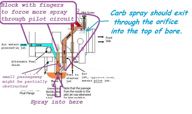

If not already done , would assure that the pilot jet is receiving fuel (through the small passageway where so designed) and that the fuel mixture is passing through both small orifices where it's supposed to enter into the carb bore.

- Maarrrccc
- Posts: 6
Last edit: 04 May 2016 09:45 by Maarrrccc.
