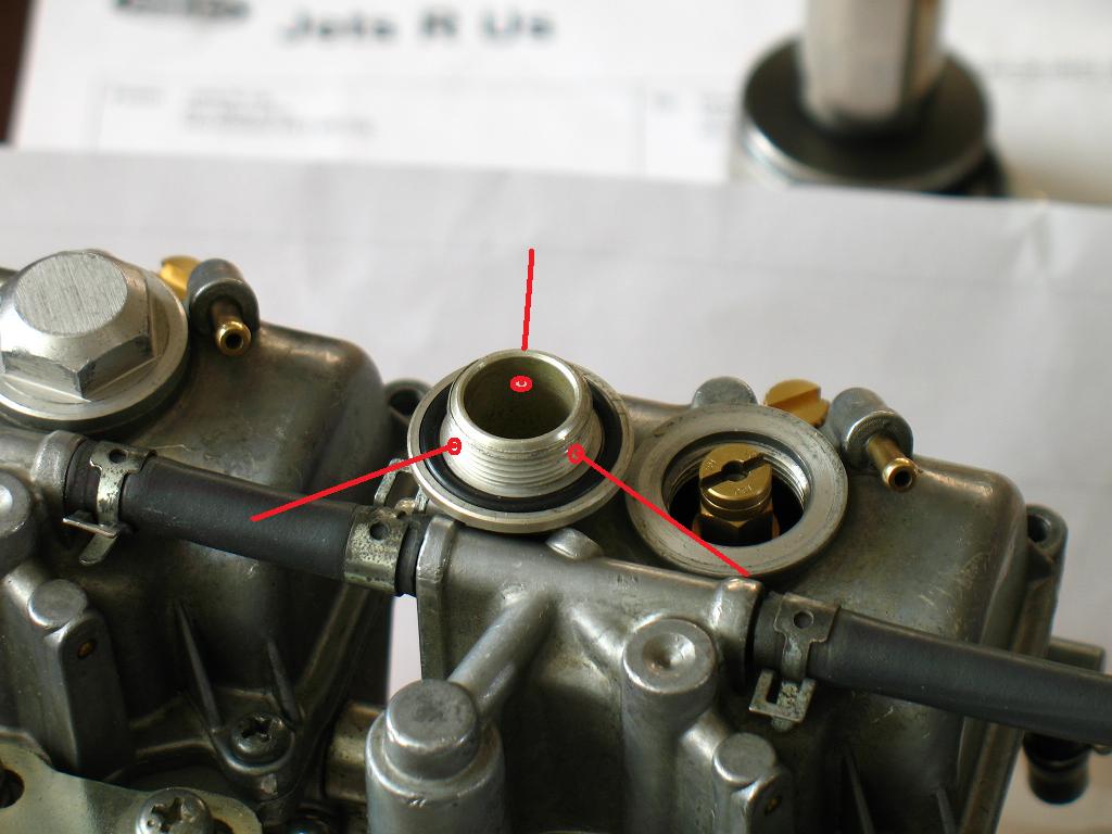

- daveo
- Posts: 3064
- Thanks: 817
Re: RS and VM drain plug removal
23 Apr 2016 02:06 - 23 Apr 2016 05:50
Not on these for some :S reason. These plugs use an o-ring to seal against the bowl.
Well, I guess its time for another experiment...
Below is a (very-nice) version of the plug currently available on ebay, with no holes either:
650ed wrote: There already is a drain hole about half way up (at least there is on the VM24carbs). Ed
23 Apr 2016 07:48
I always use a good sized rag to catch what ever the home made bowl misses too...... my drain plugs got so loose on my smooth bores I had to replace em..... lotta winter draining and jetting........ seems the bowls were made outta slightly better material cause the new plugs tightened things up again..... stockers are fine as they've only been run 7 or 8 years.
