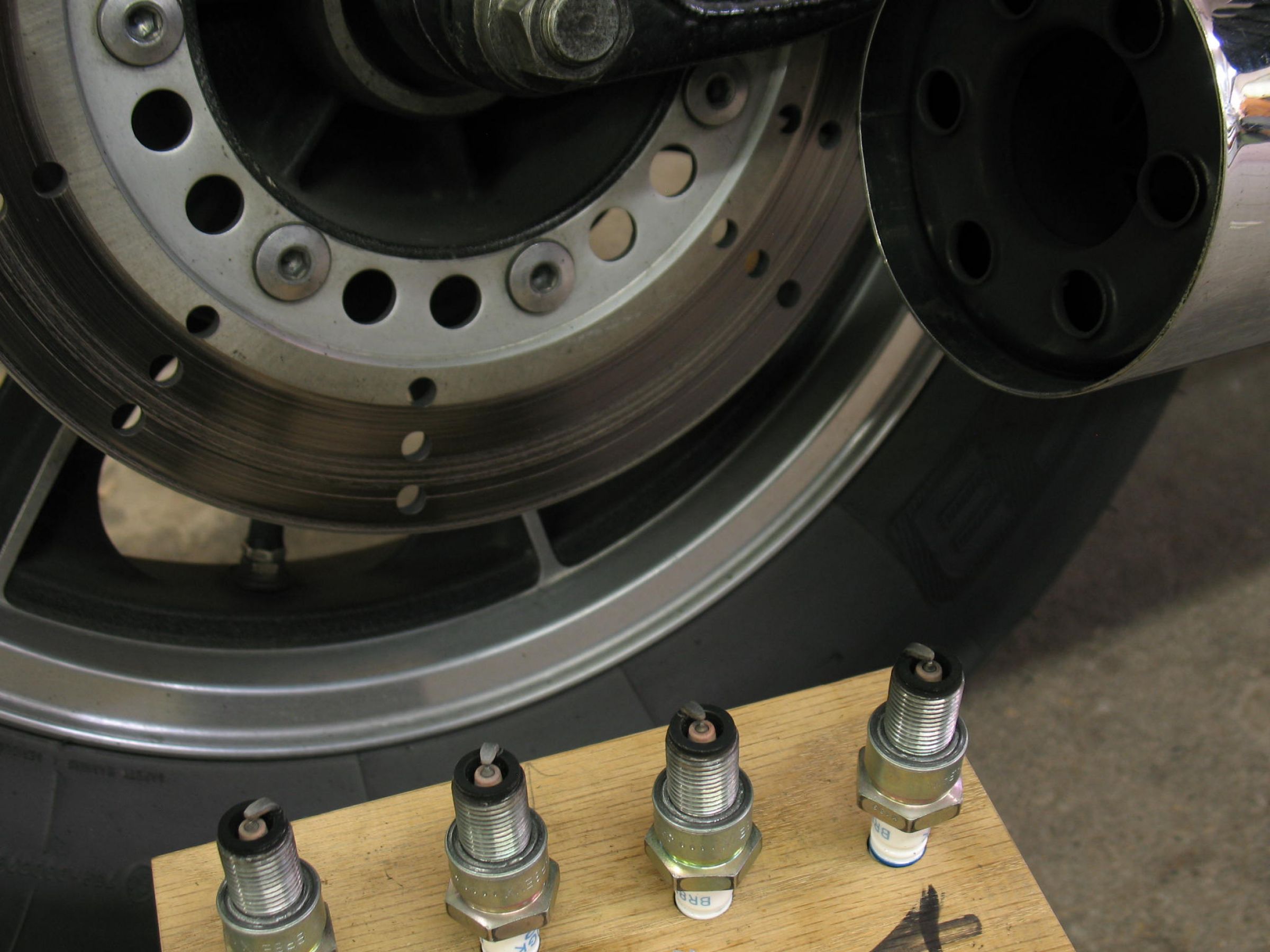

31 Mar 2016 20:42daveo wrote: Been a little rich, but last night I removed the street baffle (with fiberglass wrap) and put in the competition baffle. Now the plug color seems better, and the throttle response... :ohmy:
:woohoo: Orbiting perfection...over..
Maybe I should run the street baffle without the wrapper.
It is loud.
After a few hundred miles...
I think the plugs in pic show better color and burn, but #4 is a little-bit rich and #3 a touch lean...we're getting closer.
All pilot air screws are since reset at 3 +/- turns out (to compensate), with 132.5 jets.
The resonant sound at 5-6K is mind boggling. Beyond that it breaches nirvana. :woohoo:

Looks like my plugs. :dry:

31 Mar 2016 20:53swest wrote: Looks like my plugs. :dry:
But they ain't yours, bubba :lol:

That's good but I'm looking for peanut butter color. I had it once and am trying to find it again. :whistle:
- daveo
- Posts: 3064
- Thanks: 817
Re: Exhaust baffle change affects the carburetion
31 Mar 2016 21:10 - 31 Mar 2016 21:18swest wrote: That's good but I'm looking for peanut butter color. I had it once and am trying to find it again. :whistle:
GMO or organic, nutty or smooth? Where to find that perfect color when there are so-many variables.
PS. Maybe the dog ate it!
Just discovered something. If you right click on the photo, then left click "view image" when it comes up, you can then zoom in and see amazing detail otherwise far-beyond standard visual perception. :ohmy:

That's pretty damn close. Maybe it's the fuel. Sometimes mine has a purple hue. :whistle:
