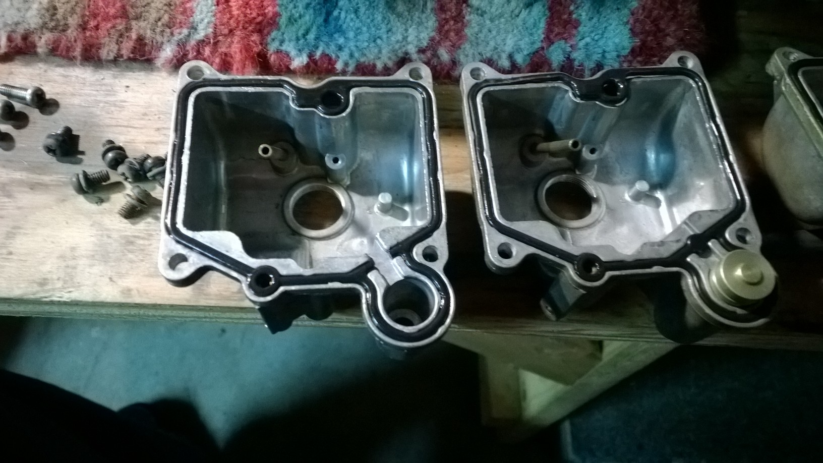

This is normal, right?

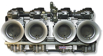

Looks just like this one from APE
I'm assuming this cut o-ring goes with the accelerator pump?
And I have leaky carb holders. Will the stock ones work, or do I need something special because of the Mikunis?
Thanks.

What carbs and bike? Nearly ALL kzs came with mikuni carbs (minus a few with keihin carbs) so you gotta be a littld more exact (bike model, carb size etc)
And what looks normal?

RS34s on a 1980 kz1000 LTD. The fuel supply tube between float bowls is not centered and is missing an o-ring.

I'm sure it isn't supposed to be missing the o-ring; but if you have had fuel in it, and it doesn't leak you should be okay. There's probably a second groove with an o-ring.

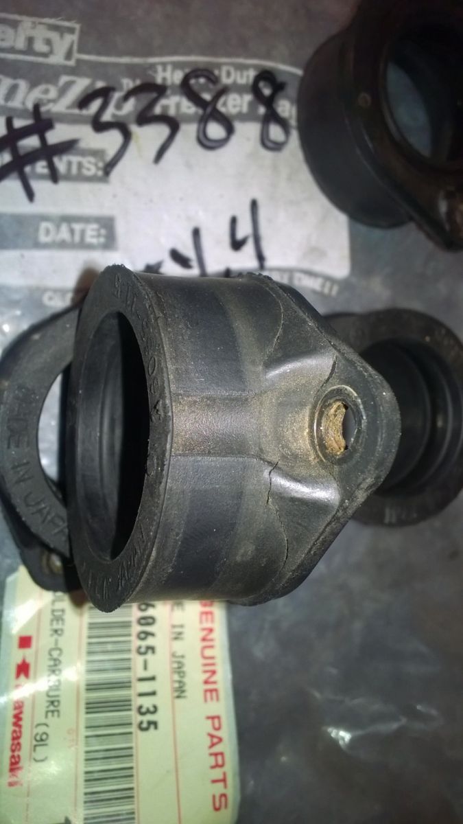

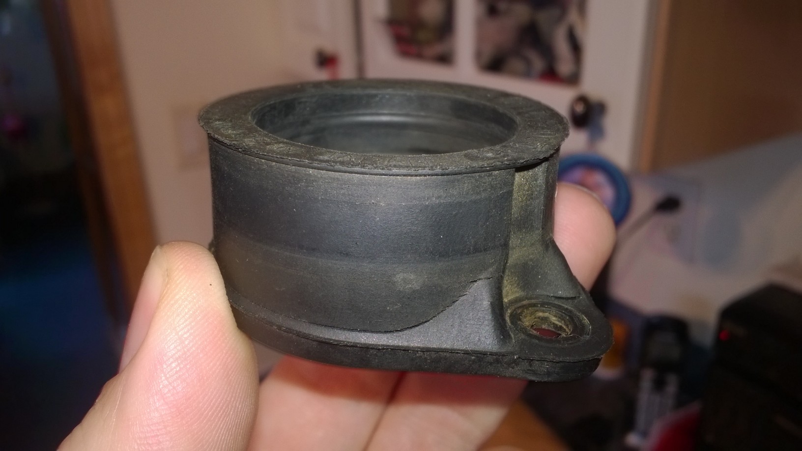

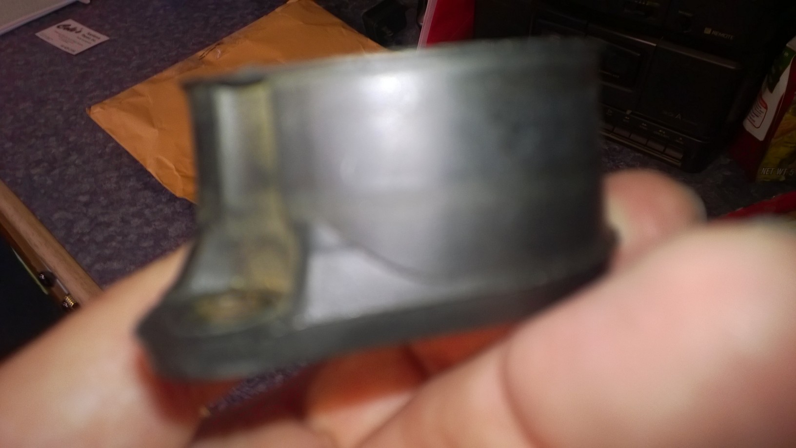

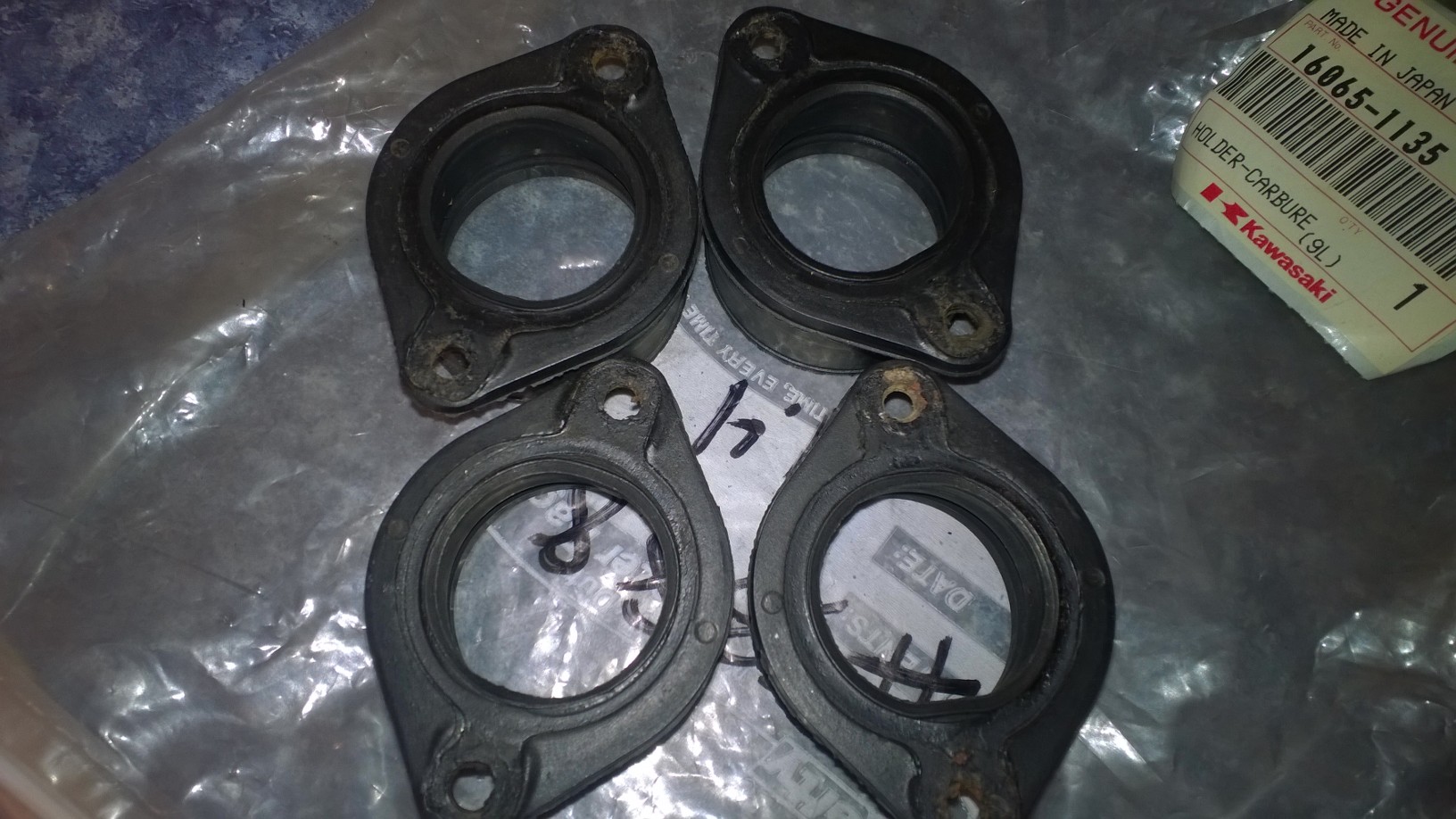

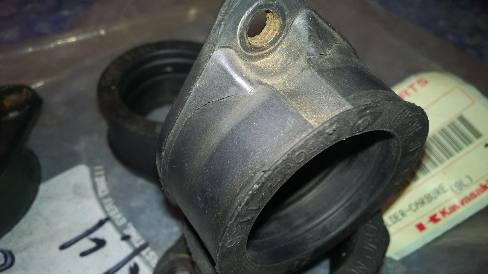

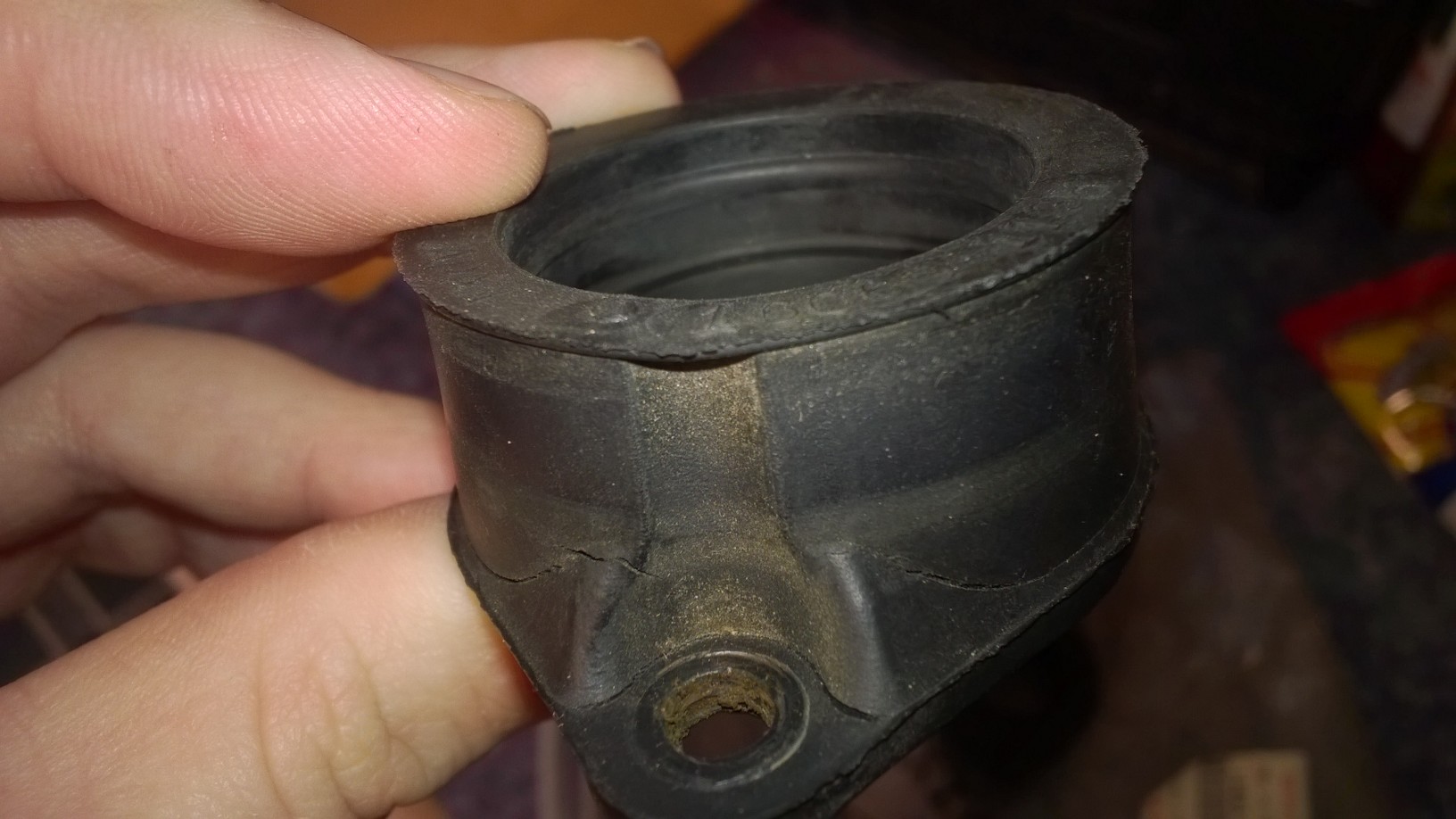

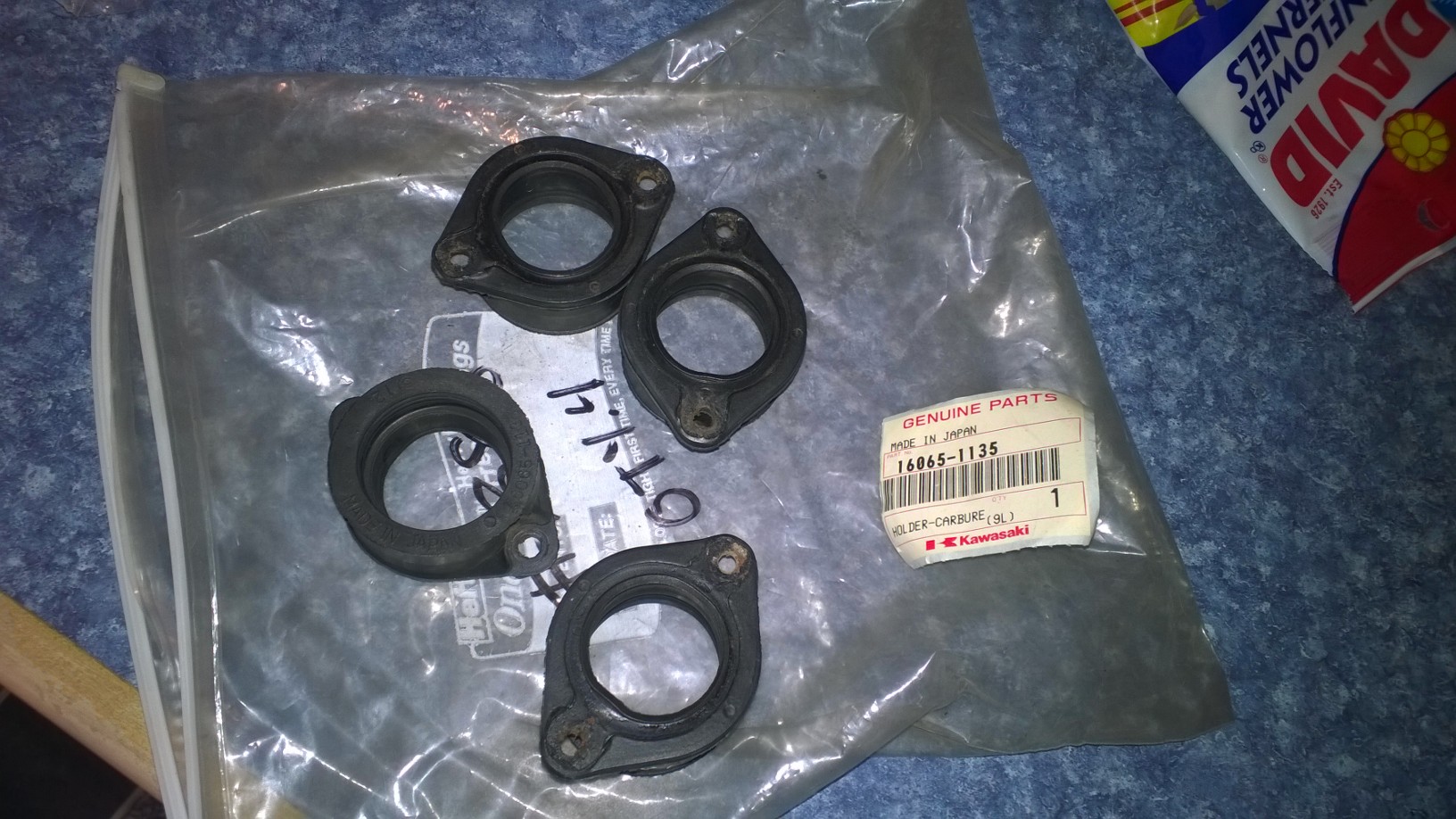

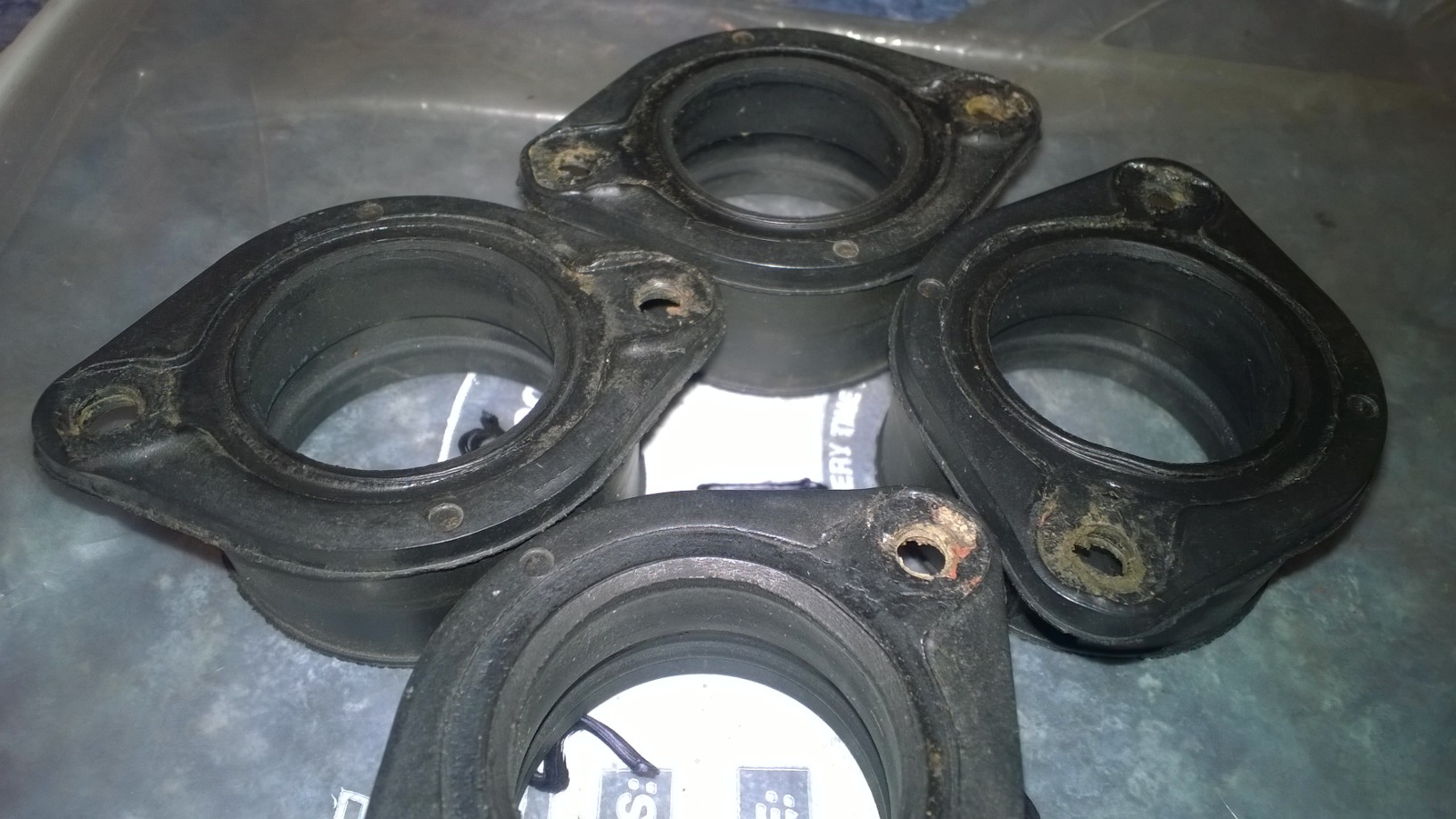

So i ordered what I thought were "new" oem carb holders off fleebay. They are rock hard, and look used to me. Do they come from the factory with cylinder head imprints burned in?
They are going back for sure, I'm trying to determine whether this was an honest mistake, or fraud.

JUNK, not as described. Leave a bad review after you get your money back including shipping. Can you post a link to your sale? I'd like to see who it is.

23 Jan 2016 11:47swest wrote: JUNK, not as described. Leave a bad review after you get your money back including shipping. Can you post a link to your sale? I'd like to see who it is.
Really!! Steve is Correct!!! Post this low life eBay seller!! Trying to pawn off these boots!!
Total JUNK! He needs his hands placed on red hot exhaust pipes IMO.
If that don't work? Then cut off his thumbs with a cutoff wheel with a 1/4" die grinder.
Then push his cut off thumbs through his eyeball sockets!
Can you tell, I have had a bad day with the IRS???????

They came from badboy motorsports. Will post a link when I get home. Just ordered OEM from the dealership. Hopefully the third time is the charm.
