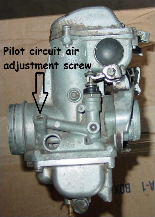

18 Nov 2015 17:20 - 18 Nov 2015 17:39JDRAKE4200 wrote: So I finally got the bike together and took it for a 1-2 mile test ride. Got her home, let the engine cool and pulled the plugs. Cylinders 2 and 3 are very rich as they are black and sooty. They were not wet. They were dry. Plugs were clean before the ride. Cylinders 1 and 4 look good. Floats are set correctly. Carbs were pulled (26's with fuel s screw behind the bowls) off during the build and the only thing I touched other than cleaning the bowls and jets, were the fuel mixture screws behind the bowls. They were all over the place so I set them at 2 turns out. Should I turn the screws in a turn and see what they look like after a ride? Please help as I am stumped.
If it's a side-located pilot air screw, turning it in clockwise reduces air which further enrichens the mixture.
Two turns out is probably far enough out when carbs are in perfect condition.
