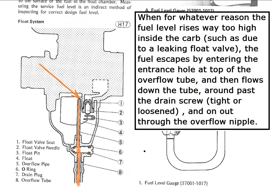

11 Nov 2015 06:20 - 11 Nov 2015 06:22eddiem wrote: . . . I need to look but wouldn't these carbs have an overflow hose?
The following diagram shows how the overflow circuit is supposed to work:
The overflow circuit may be non-functional for whatever reason, such as blockage of the overflow tube or overflow hose.
With the drain screw tightened, may spray carb cleaner through the small hole at top of overflow tube and watch for it to exit from the overflow nipple at bottom exterior of the float bowl.
Always wear protective goggles when spraying carb cleaner because the spray always backfires. ALWAYS!
In extreme cases of excessively rising gasoline levels, even a correctly functioning overflow circuit may be overwhelmed.
If the carb floats at hand are brass, would assure that none of the floats are leaking. And that the adjustment tangs look okay (i.e., have not broken off).
