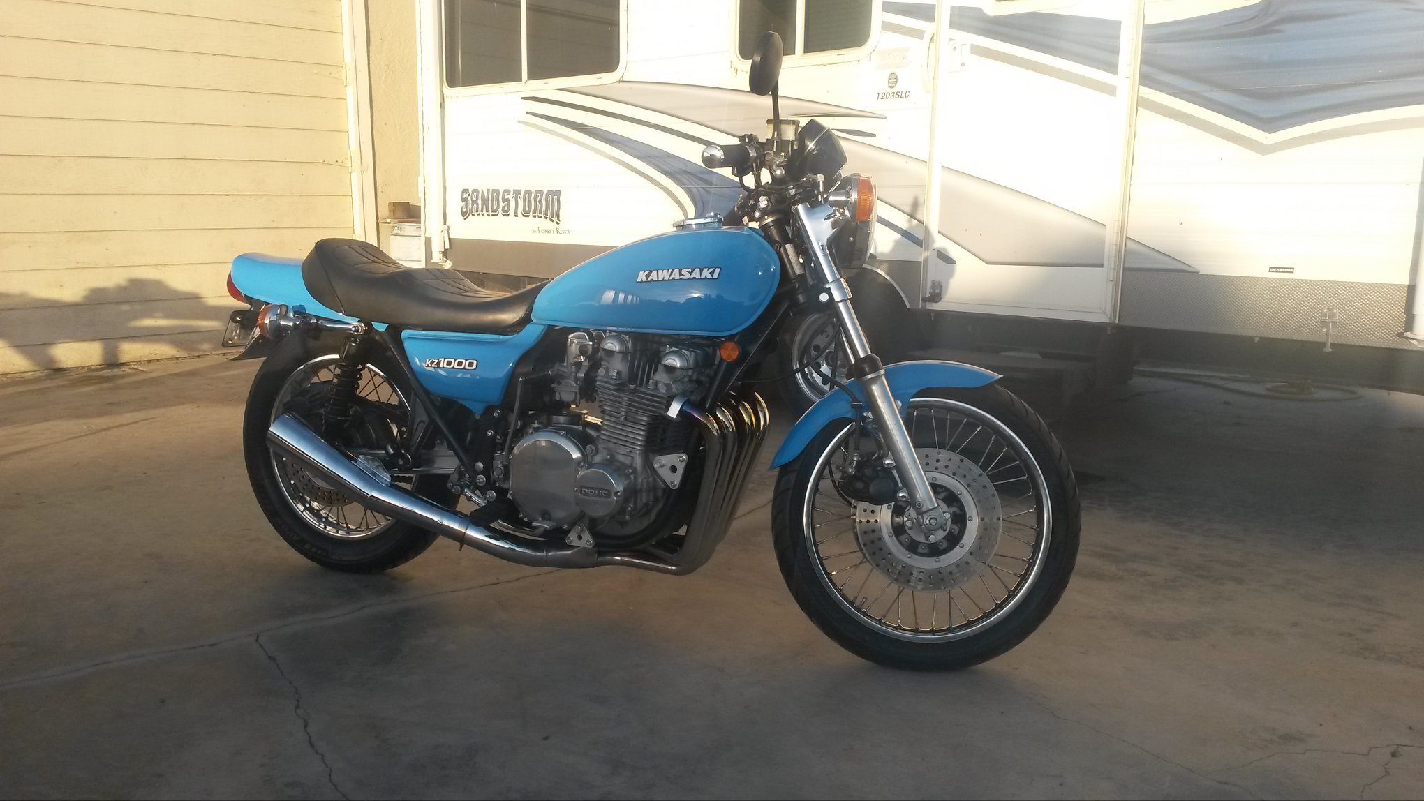

well I did get this one running this weekend after doing the carbs and new rear shocks and even got to put a few miles on it to

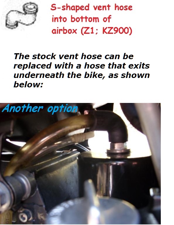

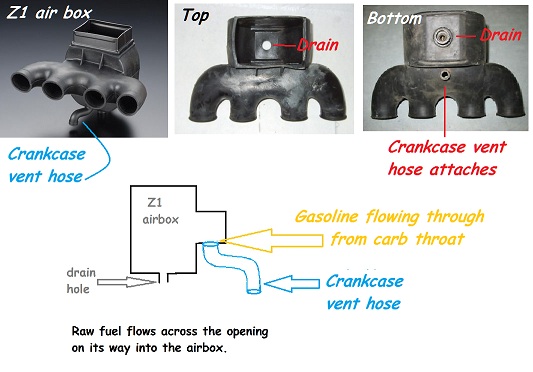

Perhaps not applicable to the bike at hand, but would check for the following possibility that can happen on Z1 models with the stock air-box configuration.
When there's a crankcase vent tube that exits into the air-box, presence of raw gasoline in the carb throat (from whatever reason) may flow backward toward and into the air-box.
Raw gasoline that gets inside the air-box would intuitively be expected to escape via a drain hole, likely through a hose attached to the drain hole which allows the raw gasoline to exit onto the road surface or garage floor or wherever.
BUT, raw gasoline that gets inside the air-box -- instead of discharging via a drain -- might flow down the crankcase vent tube directly into the crankcase. Which is a possibility with the Z1 air-box design.
Long story short -- do what's necessary to assure there's no gasoline draining from the air box down through the crankcase vent hose into the crankcase.
Carbs with a functioning overflow circuit usually avoid raw gasoline in the carb throat because the maximum float bowl fuel level is governed by height of the overflow tube in the float bowl.
However, when using carbs without an overflow circuit (such as the popular Mikuni smoothbores) -- or any carbs with a non-functional overflow circuit -- a leaking fuel valve (or other cause) may result in raw gasoline rising from inside the float bowl up into the carb throat.

10 Nov 2015 18:16I didn't check with the airbox boots off yet but before I took them off there was gas leaking from where the vent hose connects to the airbox.Patton wrote: Perhaps not applicable to the bike at hand, but would check for the following possibility that can happen on Z1 models with the stock air-box configuration.
I need to look but wouldn't these carbs have an overflow hose?
