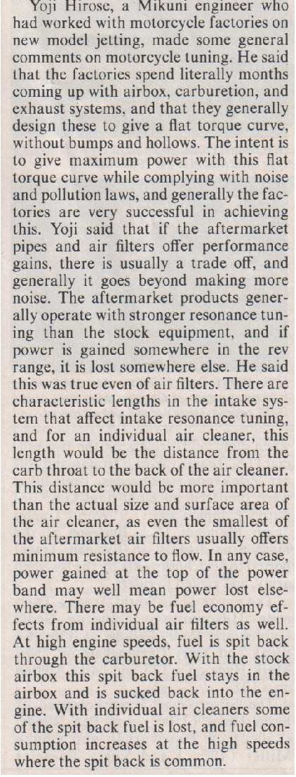

Re: need recommendation for air pods
27 Sep 2015 05:11
#692115
Required reading for pod people....
kzrider.com/forum/3-carburetor/585949-po...-a-free-lunch#585949
Plus....
