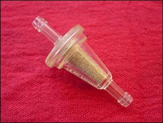

So I tried testing the petcock, and could not get gas out of the vacuum line, ordered a petcock rebuild kit from Z1E anyways. Figure it wont hurt nothing if there is no problem. In the mean time, would it be a dumb idea to plug the vacuum line and ride with the petcock on prime? Also all of the inline fuel filters I have seen have been overly large. Any ideas on where to find a small fuel filter? Thanks

17 Feb 2015 15:54Djckay wrote: ... Any ideas on where to find a small fuel filter? Thanks
Readily available at most motorcycle dealers, motorcycle repair shops, Z1 Enterprises, etc.

Here's a link that shows what I use; very small filter and super-fine filtering. Not cheap but will never need to be replaced since the stainless steel filter element can easily be cleaned and re-used. Ed
