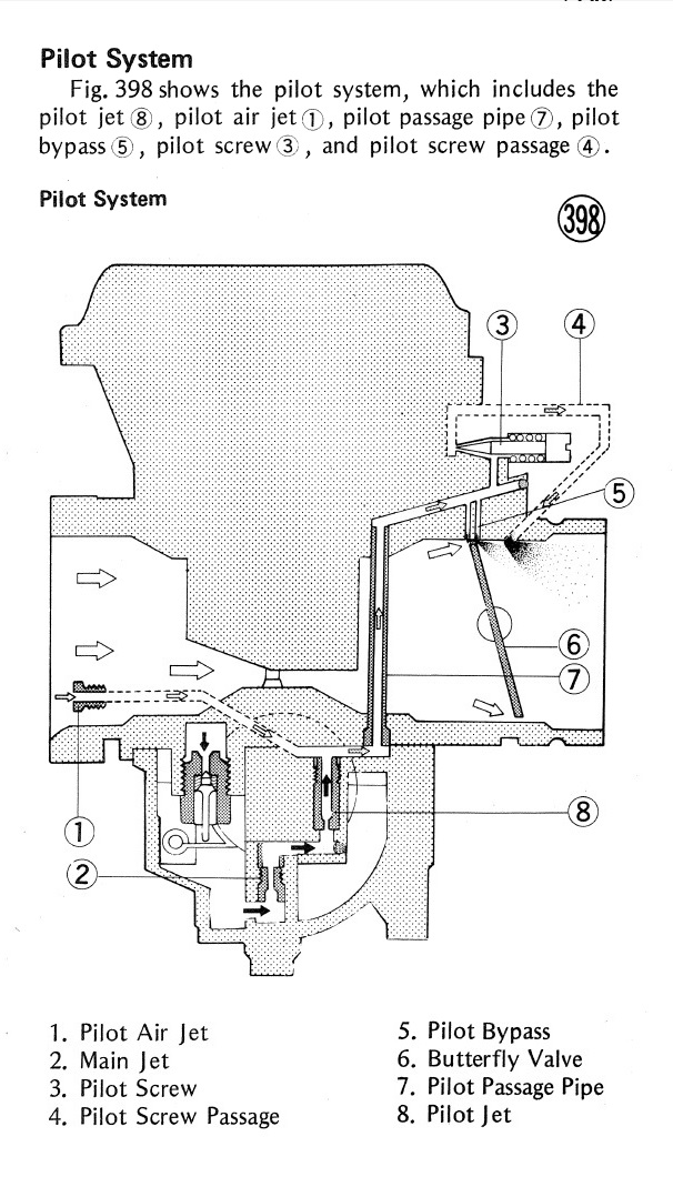

As provided in the FSM, here's an illustration of the pilot circuit in the Mikuni 38mm cv carb.
When cleaning the carb, would assure that orifices at top of carb bore are perfectly clean and clear so that the pilot circuit mixture can pass into the carb bore.
May spray carb cleaner through the various passageways to watch it exit through the orifices and into the bore.
The #8 pilot jet and #1 pilot air jet must be perfectly clean and clear.
And pointed tip of the #3 pilot screw must be undamaged and in serviceable condition.
An "as-new" pilot circuit should help enable a steady idle and strong pull-away from idle.
Memo -- This post is a revision, with thanks to 80B4 for reminding that BS38 Mikuni carbs are different from other Mikuni carbs.
