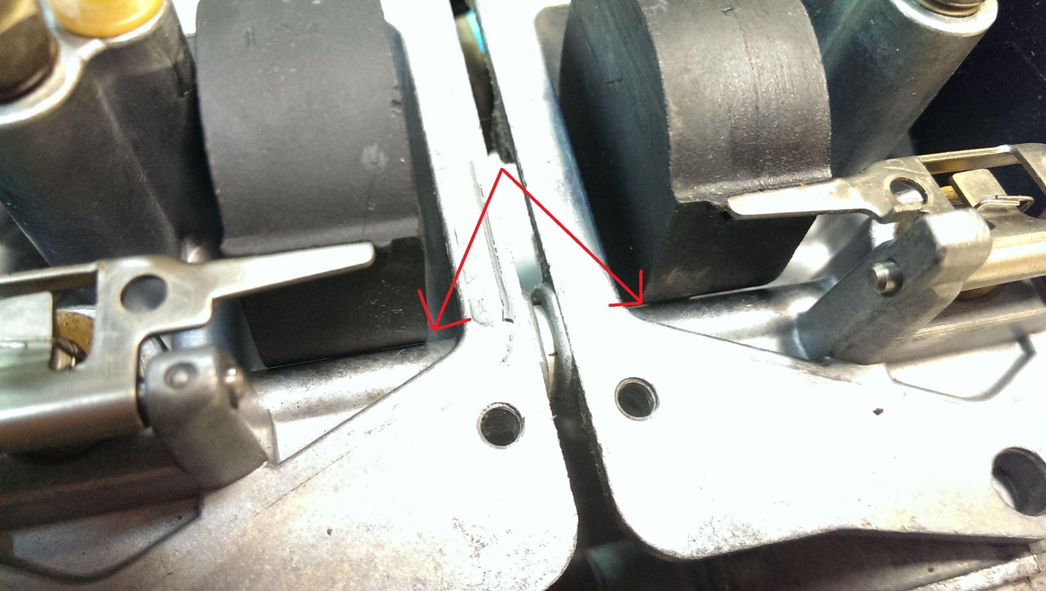

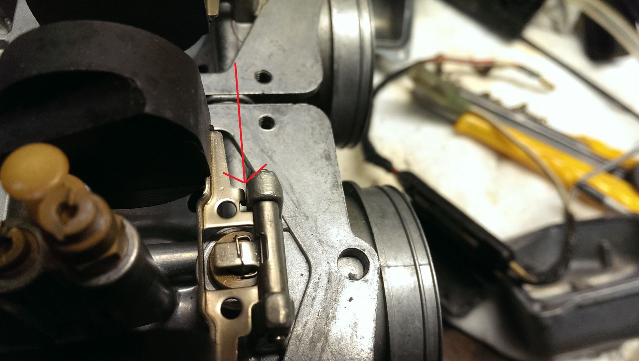

I spent some time removing the carb bowls and cleaning the float needles and seats tonight. I then consulted the factory service manual for which orientation to install the floats in and it is not very clear (to me at least). Both orientations seem to have a clearance problem. I put a couple in each position then took some pictures to share here.
In either position the float needles seem to seal up and hold about 5psi of air pressure on the fuel supply line without any leakage. However, in both positions the float is unable to completely compress the spring in the float needle before some part of the float strikes some part of the housing.
Can somebody please help?
Here are the 2 options I have available to me:
When the floats are installed such that the majority of them is up inside the housing they hit here:
And when they are the other way this little tab contacts the body:
It looks to me like when the floats are installed such that the plastic parts are fully out of the body that they will end up setting the fuel level to be about 10mm from the bowl-body seam. However when they are the other way it looks like the fuel level will be at or 1-2mm above the bowl-body seam. I tried floating the floats in a bowl full of gas to see where they want to float on their own so I am somewhat confident on these distances.
If I had to guess I would think that I need to install them such that the plastic parts are positioned inside the carb body (the ones on the left in the first pic), but that I also need to bend the tabs quite a ways to get them to settle into the right position.

The floats on the right are upside down. The floats on the left are correctly oriented. You will have to bend the little tang which presses on the valve needle in order to get the correct fuel level. Yep. Your guess is correct.
This is probably the cause of your problem but while you have the bowls off you might also check for leaks in the brass overflow tube which goes up through the Centre of each bowl.
When you reassemble carbs the best way to check fuel level using the clear tube method is on the bench. I use a gas tank from and old lawnmower

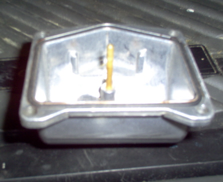

Bowl o rings are a PITA. Some expand after being in contact with gas and old ones tend to dry out and shrink.
Here's a poor photo of one of my bowls showing the overflow tube. If you dont have them then dont worry. I am only familiar with the carbs on my 1980 750/4 E1 and quite probable that the 82 750H used a different type of overflow system.

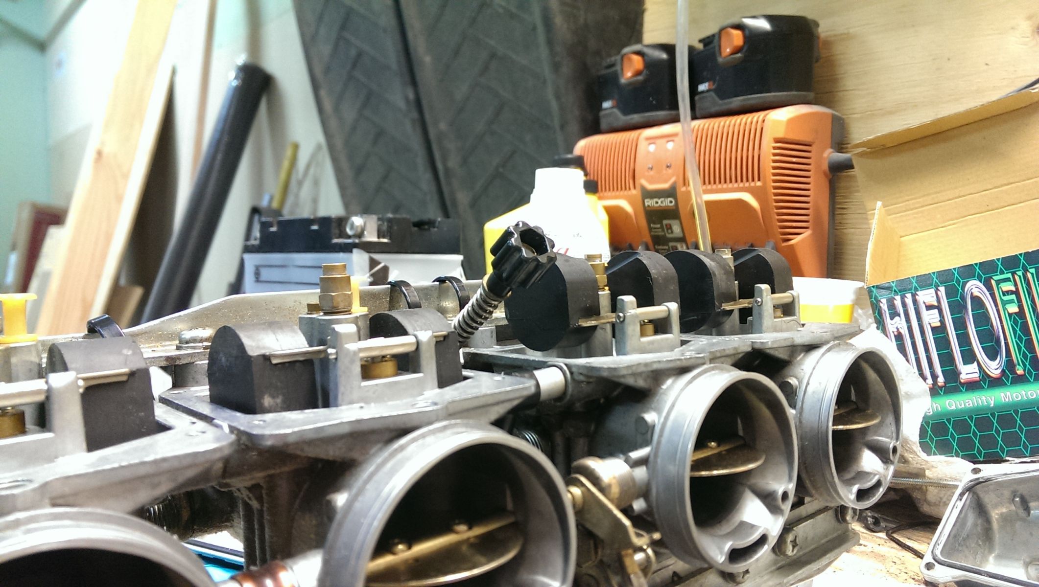

Well I fiddled with the float levels to get it so that the needle would close fully without the floats hitting the housing and after a quick leak check off the bike they seemed to be holding fuel with an okay float level (~10mm below the seam instead of 4mm). I installed them on the bike thinking I would adjust that later once I got the bike to at least start and run so I could assess the other systems.
After installing and trying to start the bike I had no luck at all, it would crank and crank but not fire. After way too long thinking about it and troubleshooting I checked the fuel levels and all 4 bowls were almost completely empty, maybe 2-3mm of fuel in them. Not sure why but they aren't taking fuel. I had the petcock in the PRI position and removing the fuel line from the carbs produces plenty of fuel so I know it's getting that far. I'll either be pulling the bowls in place or removing the carbs again tomorrow night when I have more time to look at it.
I had a hell of a time getting the carbs installed, there just isn't enough room between the air intake boots and the carb holders / carb outlet boots. Any tips for getting the assembly in and out of there?
Everything else on this bike seems so easy to access but this requires prying, twisting and levering on things pretty hard, a lot of 4 letter words then 15 minutes of using screwdrivers and little pry bars to get the boots on the intake side back into position before rolling the spring clamps back on.
My factory service manual copy has the steps between unscrew the carb holder clamps and remove the carbs cut off, is there something useful missing there?
Thanks again for any help!

Sounds like you are making progress
Best to do this on the bench if you can at all.
The intake boots should be soft and pliable. If you have the originals they might be hard. Try softening with a hair dryer. I bought a used airbox a few years ago and had to buy new intakes (Z1enterprises.com). What a difference
The trick is to fold the boots back on themselves. They are designed for this. This makes them half as long and increases the available space. Slide the carbs in. Hook up throttle cable. Slip them into the engine side boots. Roll the folded half of the intake boot forward. Roll the spring forward etc etc.
Good luck
10mm below the seam would be pretty low . Could be the reason for hard to start.they seemed to be holding fuel with an okay float level (~10mm below the seam instead of 4mm).
