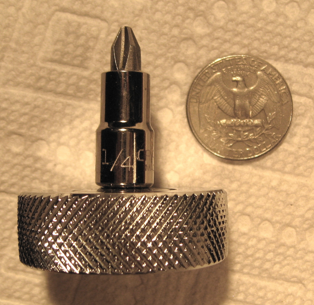

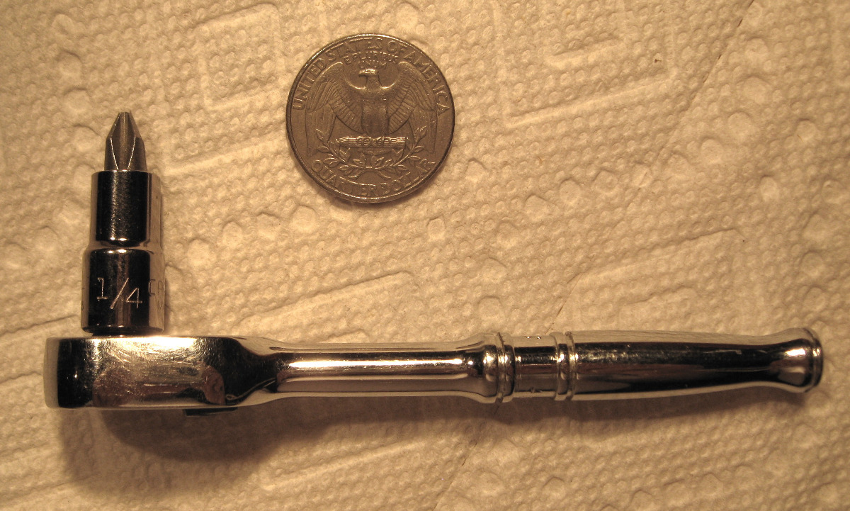

22 Jun 2014 07:30 - 22 Jun 2014 07:36bountyhunter wrote:As I get older, I get lazier. I have a way to clean carbs without removing: drain the bowls, put the drain screws back in and fill them with Gumout or Seafoam or the cleaner of your choice then plug off the gas inlets and overflow tubes. Let sit for a few days then drain. You can use carb spray cleaner in the top gas inlet with the drain screw open to rinse them crud out.tdubya84 wrote: It just seems too good to be true to not have to fully disassemble the whole carb at this point, while just trying to get the bike to run properly....
That said: if you make a custom screwdriver for the bowl screws, I could always get the bowls off without removing the carbs so properly cleaning the carbs got really easy. On mine, the jets are in the bowl so cleaning it usually cures all sins.
Excellent point! I have never removed carbs to take bowls off. Below are some tool suggestions for removing the carb bowl screws with the carbs still on the bike. Ed
Attachment ShortScrewdriversA.jpg not found
